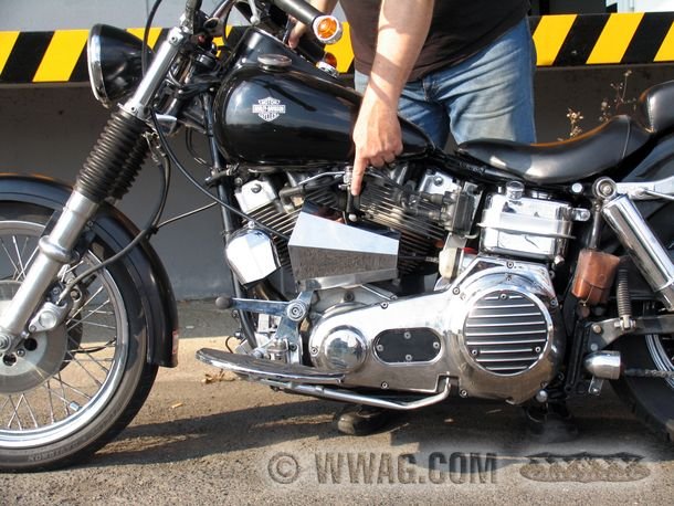

Screams 90s excess bling and 'all about the looks' to me. As if gas isn't expensive enough. They were around $900 new.
The two carbs feed the plenum, a box, and then the cylinders suck it in from there. Strikes me under power it'd be sucking unevenly from the closer, straighter path carb and not so much from the longer, having to take a turn back on itself, second carb. How would you jet and adjust for that? How would the collision of gases affect the flow?
If it's look, they'd have been better to make one like an old fashioned Shovelled cooling scoop.

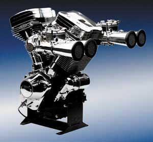

Did anyone ever make a two carb conversion for big twins using XR style head set up? Two front heads? Again, I read of guys doing such conversions to Sportsters but coming back saying performance wasn't worth the work.
I suppose these days, with short track fuel injection and CNC heads, you could make a far more compact conversion with much straighter tracks.
Someone else did the same with two, dual 45mm Webers for a cool $3,000 plus.
The Trock X-head was in fact two Rear Heads.. easily done on a Sporty certainly..
But, the Intake is a Nightmare [needs to be longer than you might at first imagine]...and since we had to Hand build every damn piece... it took alot of time..
Ron [Sr.] wanted to try 2 Bored CV's... we just never got around to it...and now, of course...it is too Late..
My Biggest Bitch...again, was the hand strength required to twist two conventional Carbs WFO in 1/4 of a Turn.. I was never Limber enough to get along with 1/2 Turn!!!!! Much better 1/8 turn for my lazy ***!!!!!
To answer your Question... Not at the Race track... and not that actually Worked...nor certainly worth the $$$$
And... it was Not for lack of trying.. But, I would Not tackle a big twin... mostly because of the cost of One-off Cam... that is at risk of Damage Every Pass!!!
The Sportster X-Head cams remained the Very Same!!!!! Ron was pretty Swift like that!!!!!

I understand that part of the idea of a scoop, and a plenum, was to build pressure so when the engine opened its throat, it had a whole lot more rammed down it than it could have drawn in itself.
But the Kuryakan's are fake scoops too. They are open at the back so any extra air coming in blow right out. Presumably they did that to get around the jetting problems of having a whole lot more pressure at 90mph WOT than 20mph WOT. So would this design build pressure? I doubt it. I would say it's just mixing chamber with gases going everywhere due to its square shape; and what happens at the crossroads where the two tracks meet?
