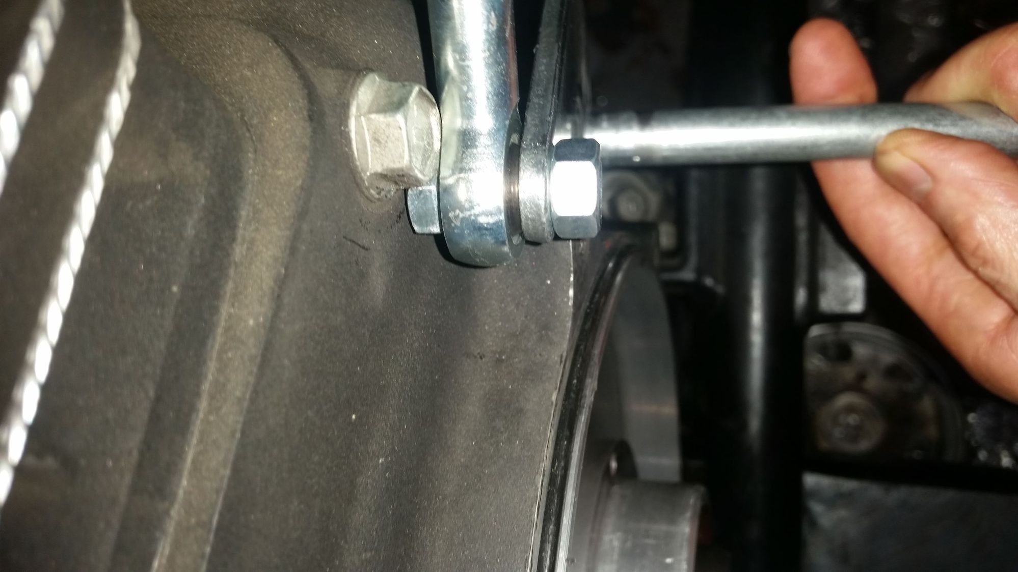

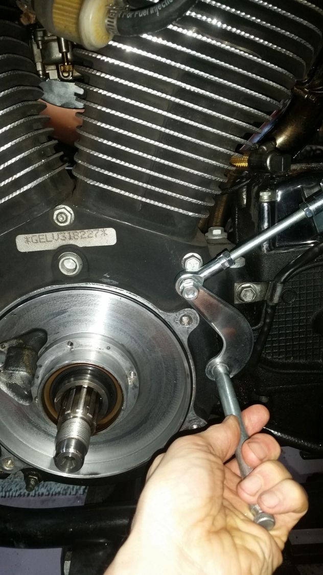

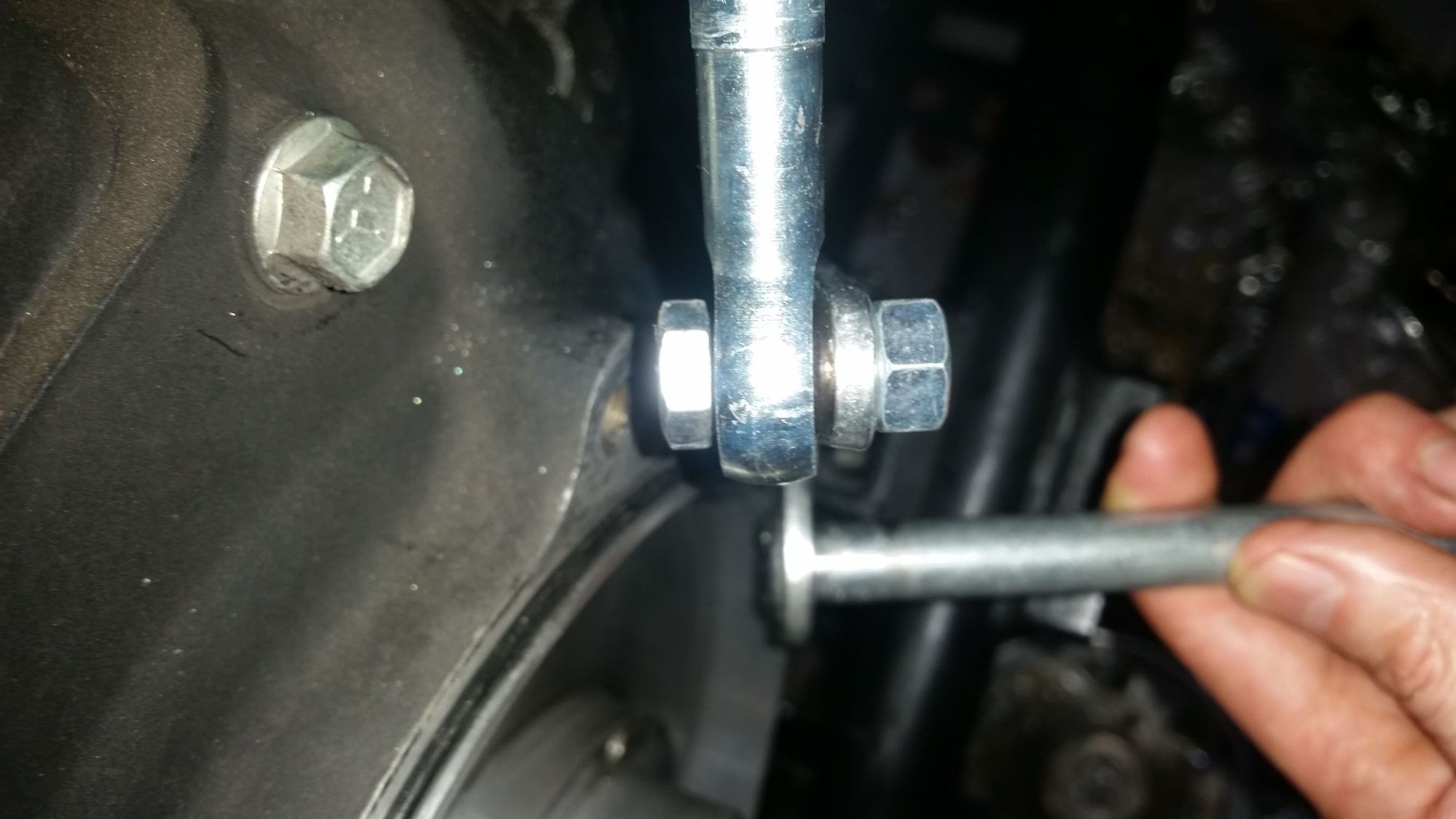

Have some questions on the shifter side as I having fitment issues with the bolt and nut. My initial thought is to try to find a half size nut and see if that works. Pictures of issue:

You shifter linkage is supposed to go n front of that splined shaft toward the outside of the bike. Also that shaft looks short to be for a Dyna height wise. I also don't think it's going to sit as far down as you're holding it

Thanks. I thought the same thing on the shaft being too short when I looked at pictures online. The part # for a Low Rider = 34621-90.

Finally got everything buttoned up and running. Believe I have it retuned good now too. Thanks to Misfit Jason for the heads up on the shifter shaft.
Went with the Vulcan Engineering shifter shaft sleeve which is metal vs. the OEM plastic. Wouldn't fit at first - oh cr*p. Lol Rolled Emory Cloth and lightly sanded (~ 45 minutes) the inside and used a little lube and it fit!

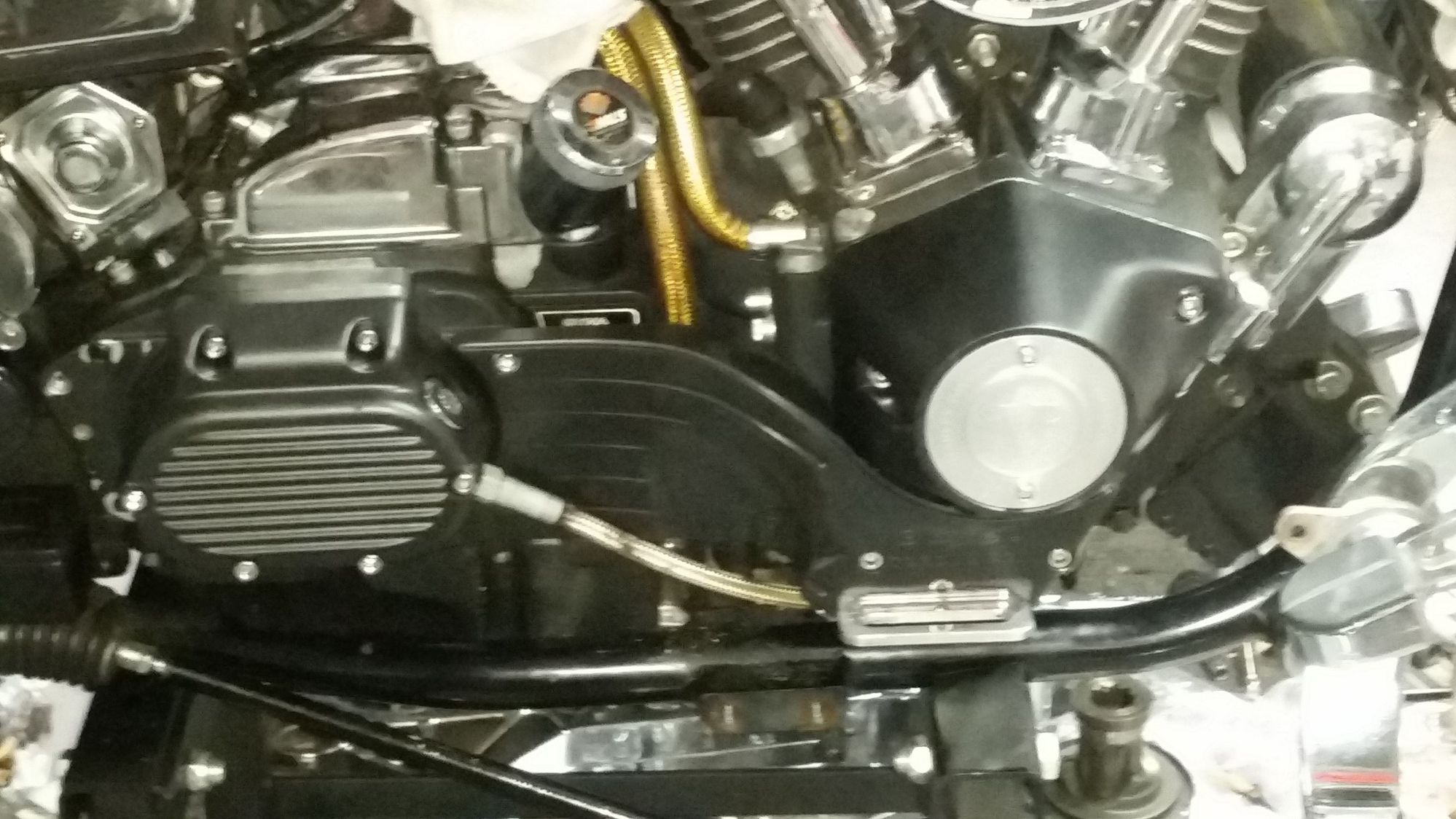

While parts were off, I used PlastiDip to black out some of the chrome items to see if I would like the look (see red circled areas in pics) This also necessitated spending another $100 on chrome bolts at the hardware store.
