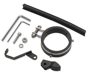

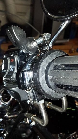

http://www.soundoffrec.com/products/cruise.aspx
Best $30 you'll ever spend. Used one on my Shovelhead and an now on the Heritage Classic.

I've got a similar throttle lock on one of my bikes but the issue I have with it is climbing hills - my speed falls way off, I have to disengage the lock, speed up get over the hill, re-engage again. It seems to work OK on level roads but I found it unusable if hills are involved.

Not with the Vista Cruise. Once you have the acorn nut adjusted properly you can make throttle adjustments without disengaging the lock or with just a couple flips of the thumb off and on again. I love it.
