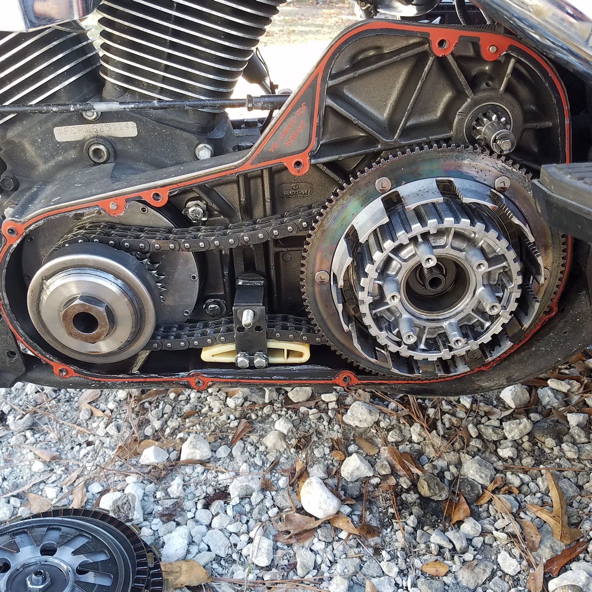

I have to say that I've not seen frictions with that much fluid on them.. what are you using in the primary and how much.. how many ounces.. but they do look very healthy..
Using type f in primary, in amount spec'd in manual.

Does the noise stop when you put it in gear?
Really have not noticed. Hope not ipb.

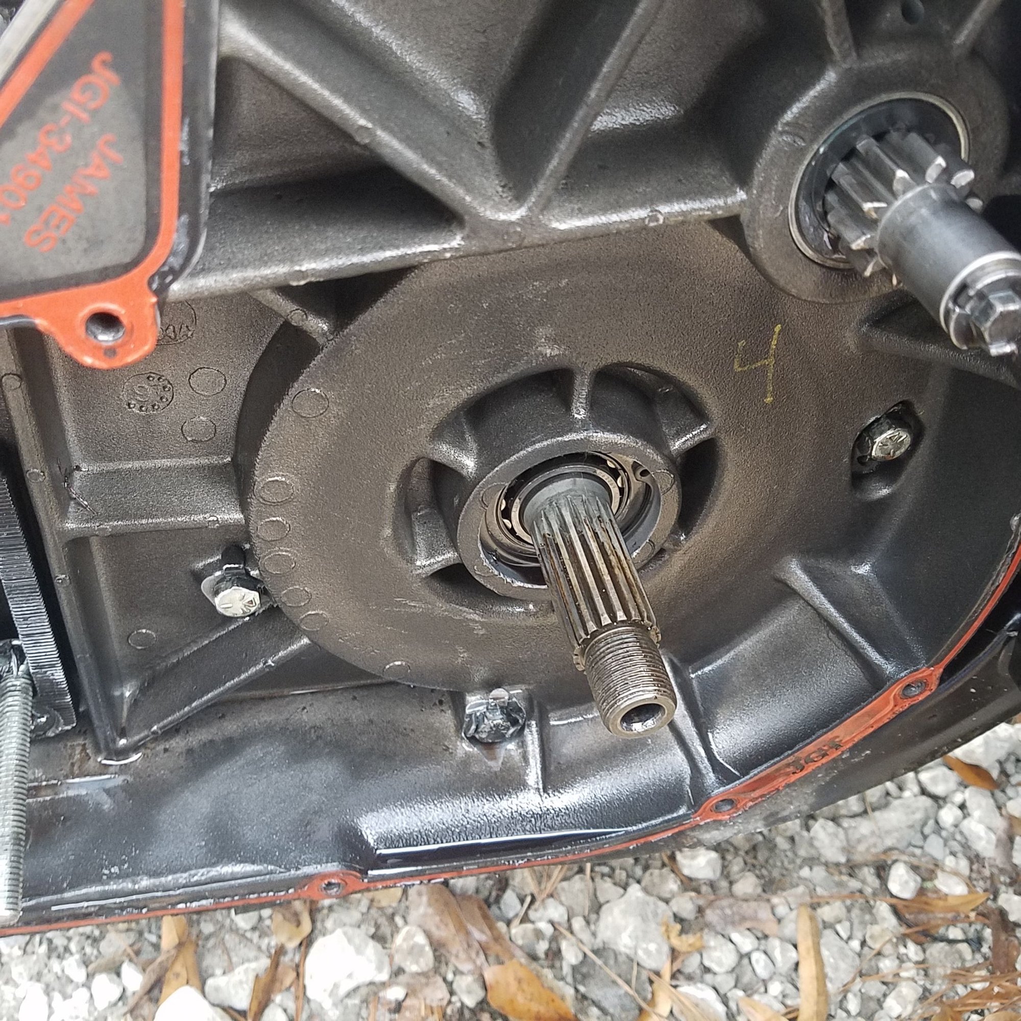

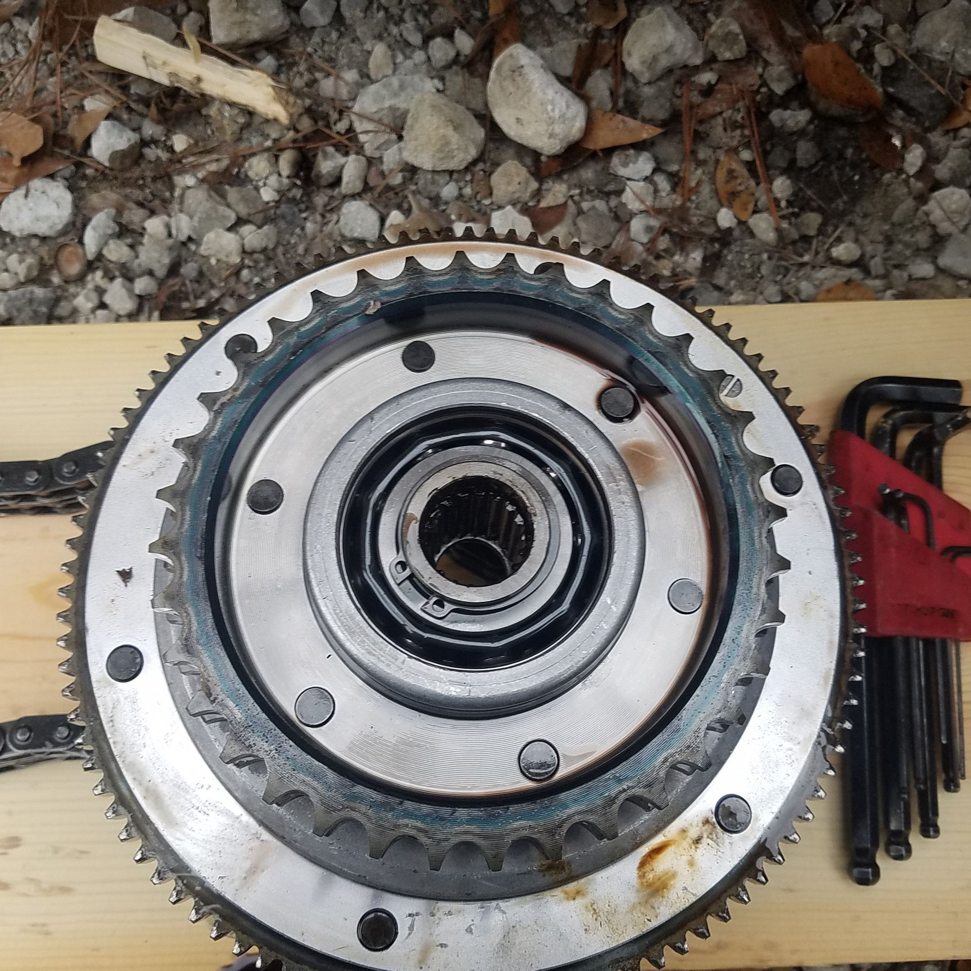

Clutch and compensator off. Basket bearing and clutch shaft bearing look good on inspection, spin freely. Work has been done on clutch before, but not correctly.There was a friction plate between the damper spring and damper spring seat. Probably why I couldn't adjust out my clutch drag.
I'm gonna put it all back together and see what's what. If noise persists, on to the inner primary. Ken

Ok, now I see the narrow friction plate is supposed to be between the spring and seat. The spring seat should come out also, but doesn't. Ring in pic must be it?

Cleaned everything up, put it back together. 28 oz type f. Fired it up, noise is gone. Mystery to me, but not complaining. Goin' for a ride. Thanks, guys. Ken
