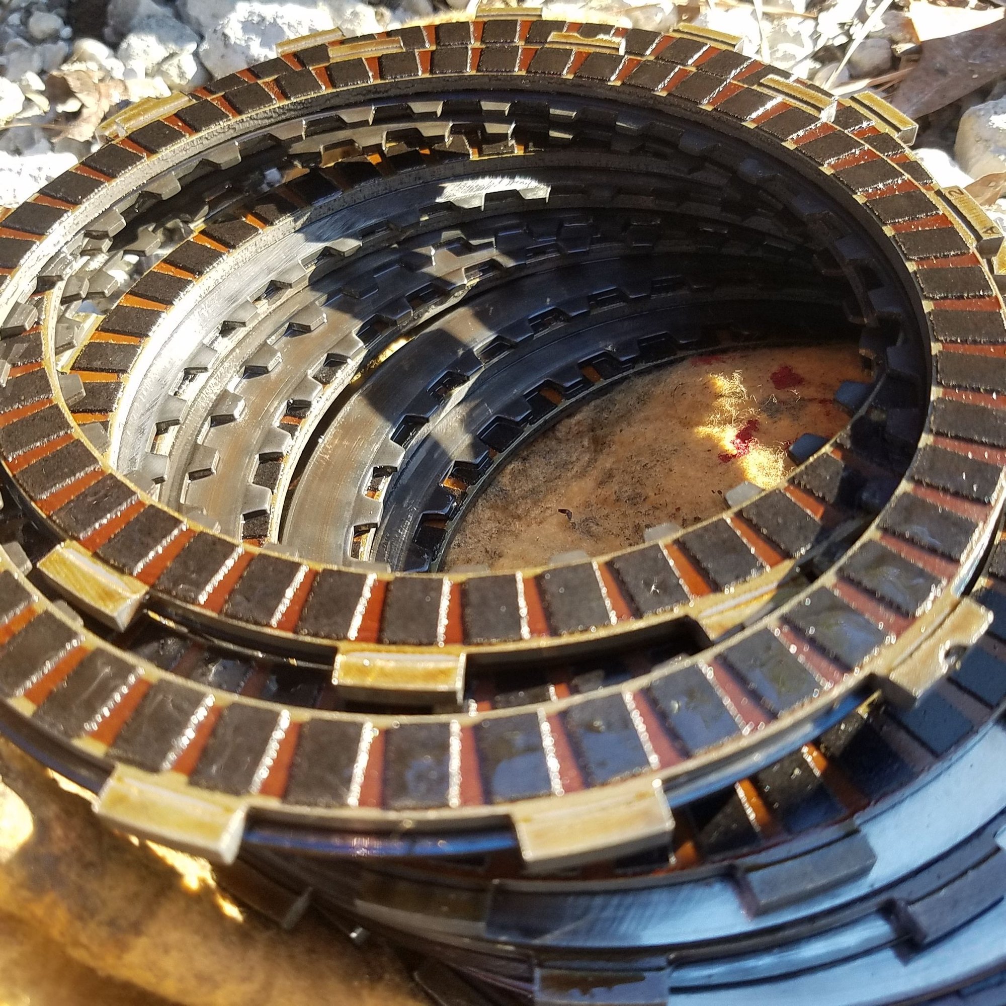

Dunno if these friction plates look ok or not. Are tabs supposed to be thicker? Not much material there.

Does the noise stop when you put it in gear?
They look good to me but you have to put a mic on them to be sure.

I have to say that I've not seen frictions with that much fluid on them.. what are you using in the primary and how much.. how many ounces.. but they do look very healthy..
