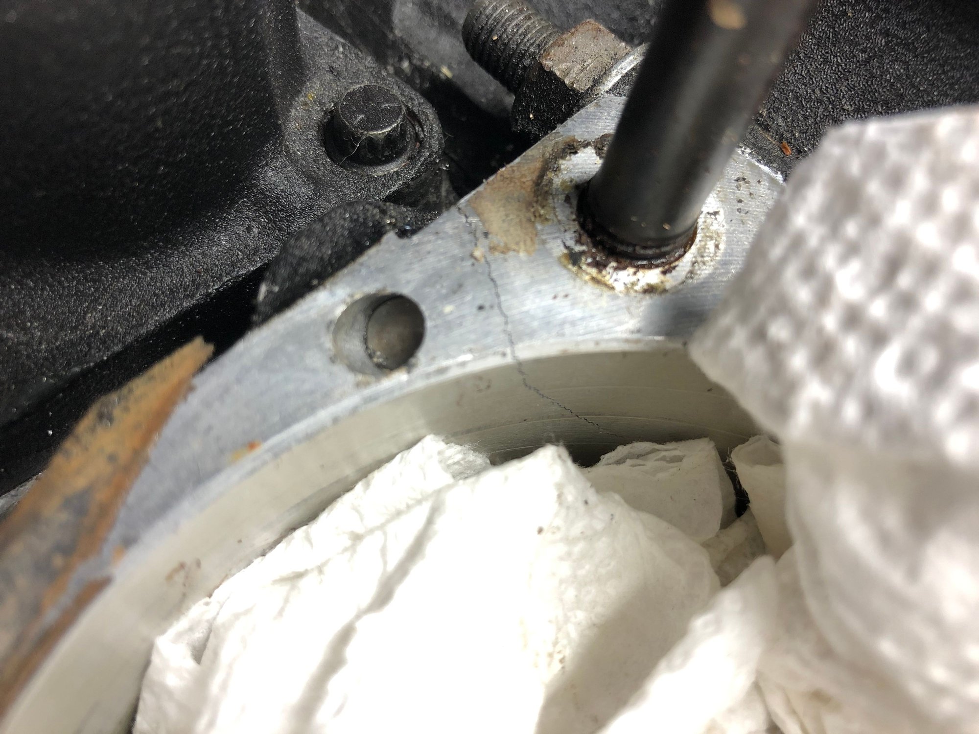

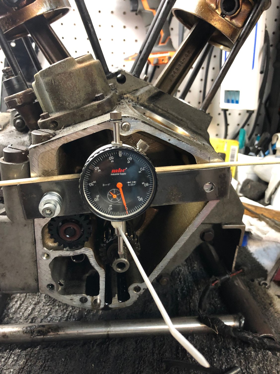

I originally had a motor out of a 91 with less miles but found the dreaded block crack behind the lifter.
Luckily the 86 bottom end checked out ok. Bike has 60,XXX but the crank was tight and runout was under .010

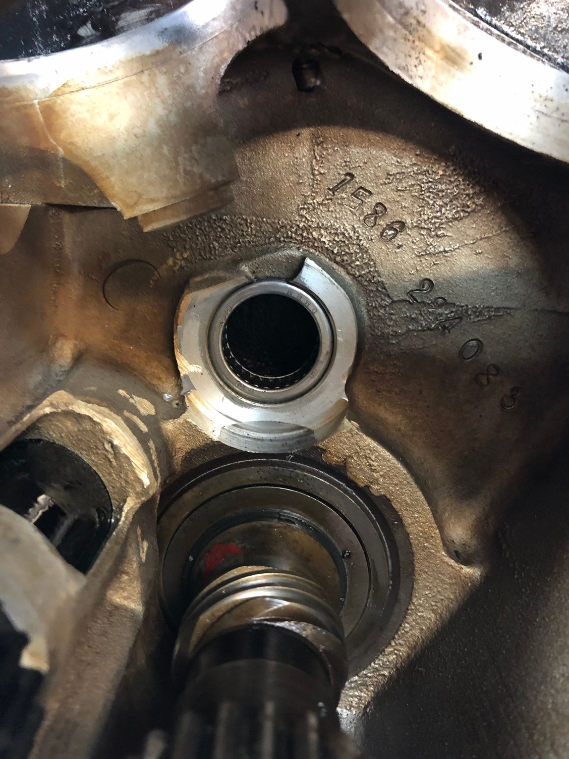

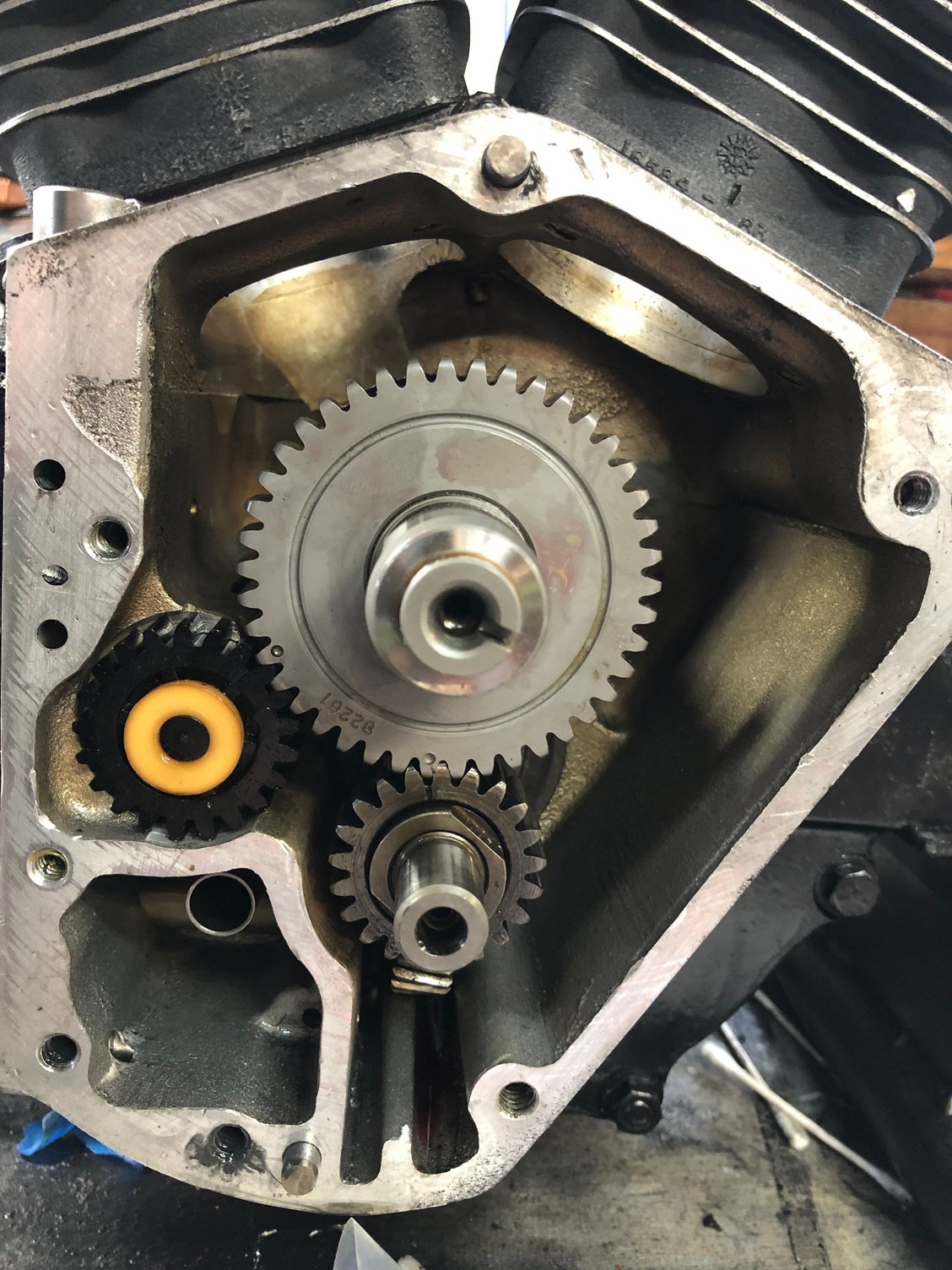

Today I got the cam bearing replaced. I was trying to set the rocker box but I need a thicker cam shim to bring it back to .015

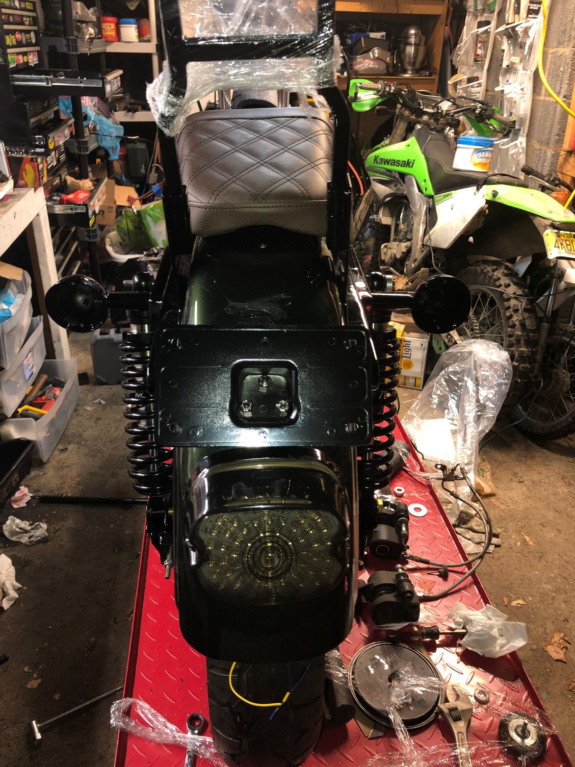

Waiting on a thicker shim I got the rear fender on and couldn't resist throwing the seat on.

“Dreaded block crack”.?
First I heard of it. But I’m real short on on Evo knowledge with no personal experience other than a couple short years with modern sporties
