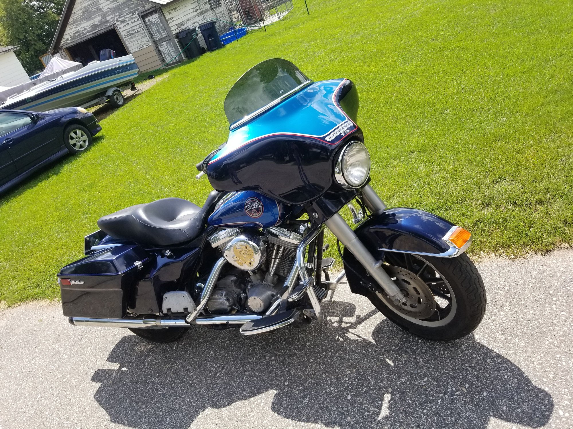

I have a 1987 flhs. It has a base gasket leak so I figured it get it fixed. Since I'm going to have the top side torn down I figure I'll do the cam and bearings as well. Going with an andrew ev27 for the cam. New lifters and adjustable rods. I'll also check heads for trueness. I was thinking about changing the ignition as well. Is there anything else I should be looking into to replace on these 80" evos? Also right now the bike has a super b carb, I know it's a low end roll on carb but I would like better throttle response. Would it be worth going to a super e or a mukini?
