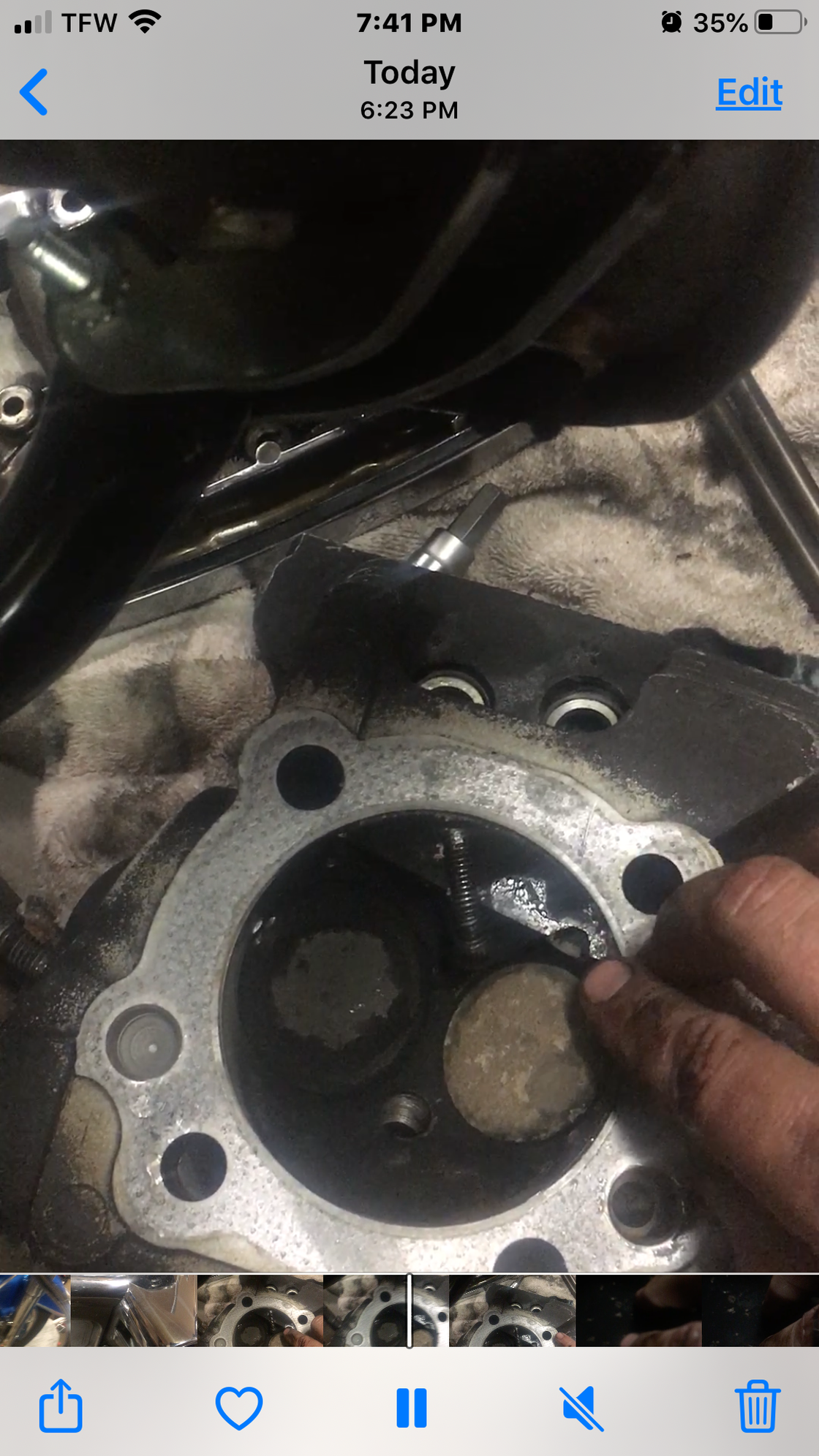

Are you running an S&S E carburetor? If so you should be using blue loctite on the air horn bolts.. definitely gonna need a tear down. Post up some pics when torn down, of the combustion chamber and the top of the Pistons.. All repairable but the cost and downtime suck..
exactly what happened
Old Feb 18, 2020 | 09:54 PM
Steveareno's Avatar
Steveareno
Joined: Oct 2018
Posts: 59
From: Sacramento

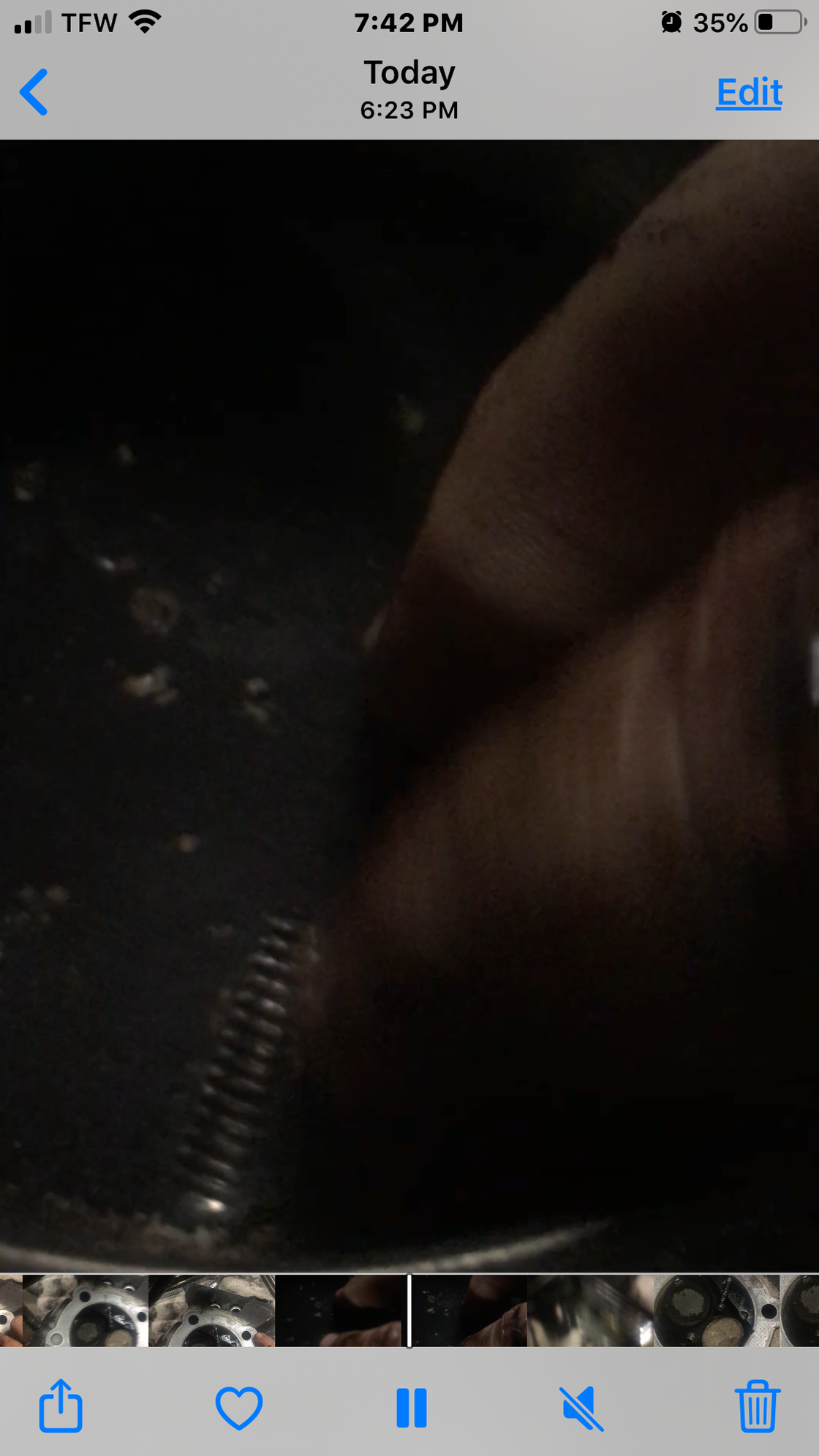

So the head has a chunk missing out of it. The piston has a bolt imprint in it. Thinking I’m just gonna rebuild it. Stroke it, get some jugs pistons and see if I can massage that head a little. I know a guy that can tig weld it fo me. And I’ll just fix it. Already have it torn most of the way down
