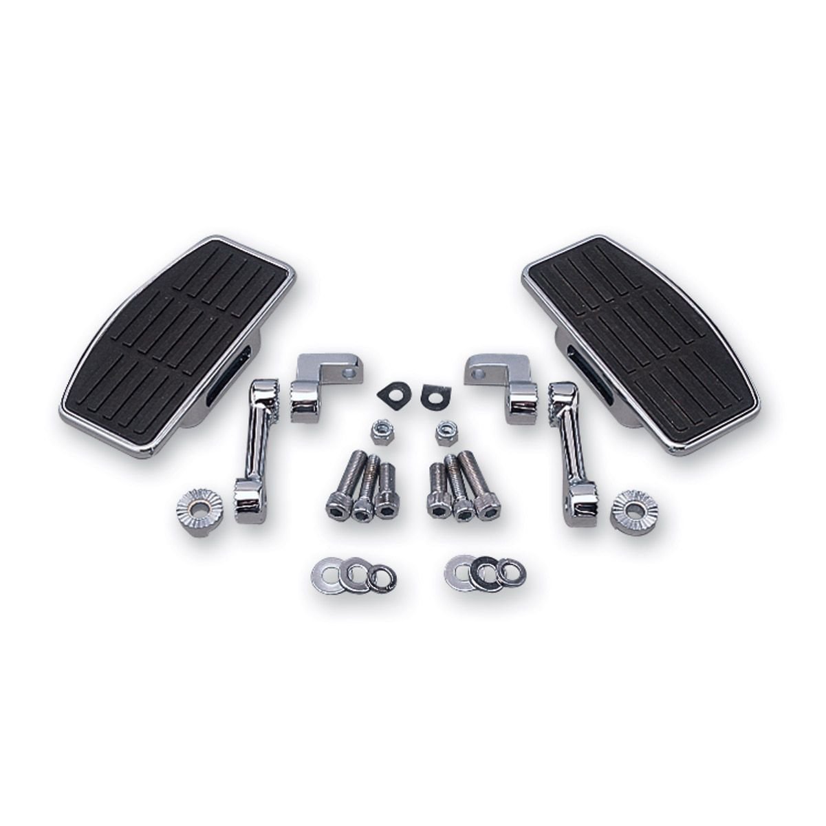

The forward control pegs blow chunks. Damn near impossible to keep my shoes from sliding off, they suck. J & P has 7 1/4" fully adjustable mini boards for under 160, free shipping. Anybody know of something better/longer don't be shy.
These look like the same exact ones I bought to use for passenger footboards my '96 Heritage. But mine came with two more parts than are shown in your pic.
I ordered them from J&P, they came in a J&P-labeled box with no mention of Kuryakyn on the box or on the parts or on the instructions. So I don't know who made them, but the box does say "Made in Taiwan".
These mount to my bike with only a single bolt, and I still need to figure out some way to keep them from rotating if my passenger puts any weight on either the front or back ends of these. So I still don't have them installed yet. But I'll come up with something one of these days...
Honestly I don't see a single bolt mount for the floor boards holding up to well.. Especially for a passenger. You know she's going to stand up on them to get off your bike..
You're exactly right. Especially my height-challenged wife...

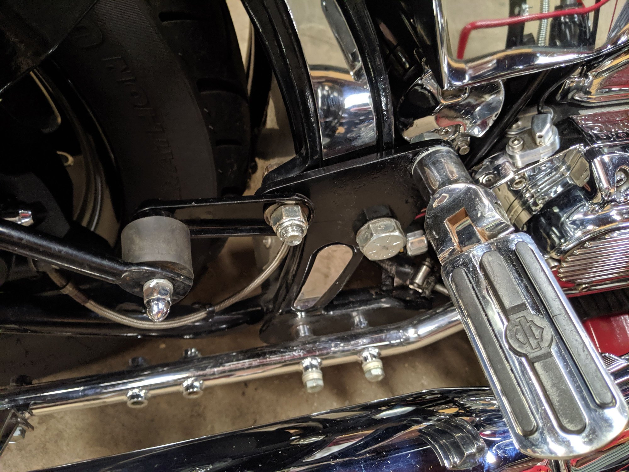

In another recent thread, TexasHillCountry posted a picture showing how the passenger floorboards he installed on his '95 Heritage have a bracket that uses the swingarm bolt to stop the floorboards from pivoting. I'm pretty sure I can weld a similar bracket to the floorboards I bought.
One nice feature of these floorboards is that you can adjust them up or down, forward or backward, a few inches each way. So you can get them the right height and in the right position to match the passenger.

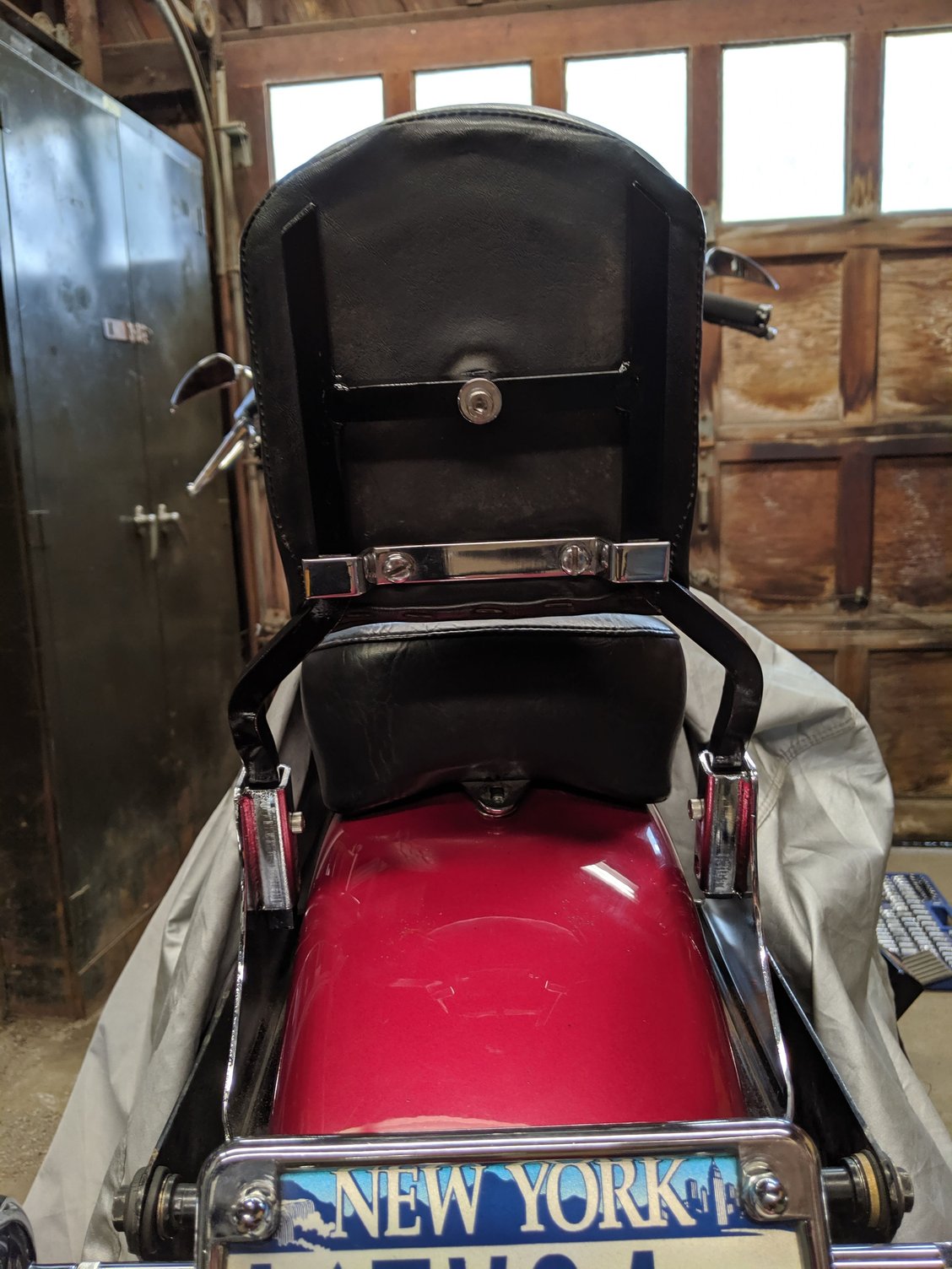

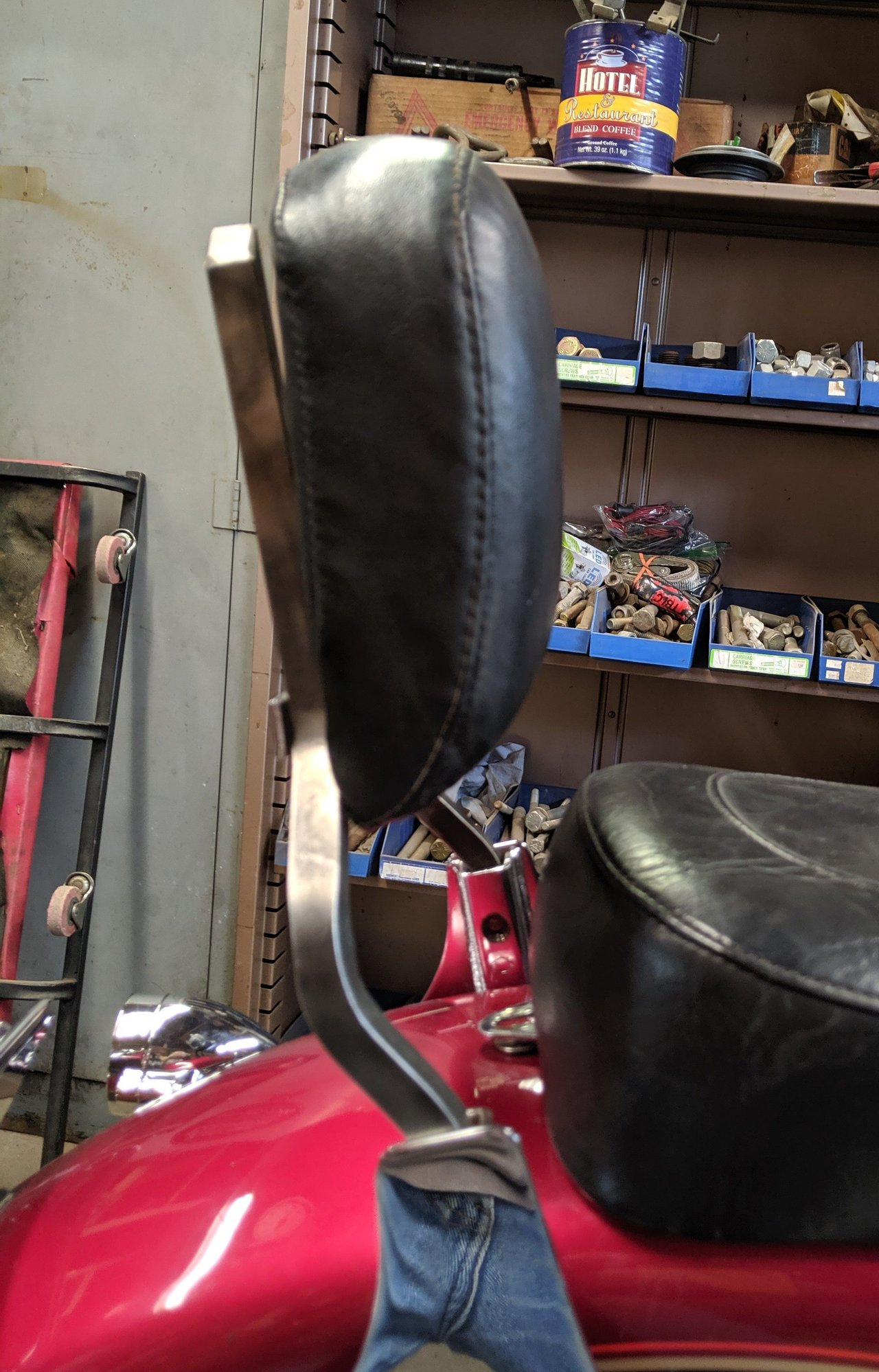

It's always tough for a passenger on the softails. My wife couldn't ride that long cause she would have hip pain so I did a couple things that so she could extend her legs a little bit still used the pegs. I made a triangular plate (mount) and attached it to the old mount and swing arm pivot to move it up and forward.. Huge difference... I also fabricated an offset backrest (sissy bar) 1 inch to give her more let room.. Out rides last a lot longer now cause she's more comfortable..
