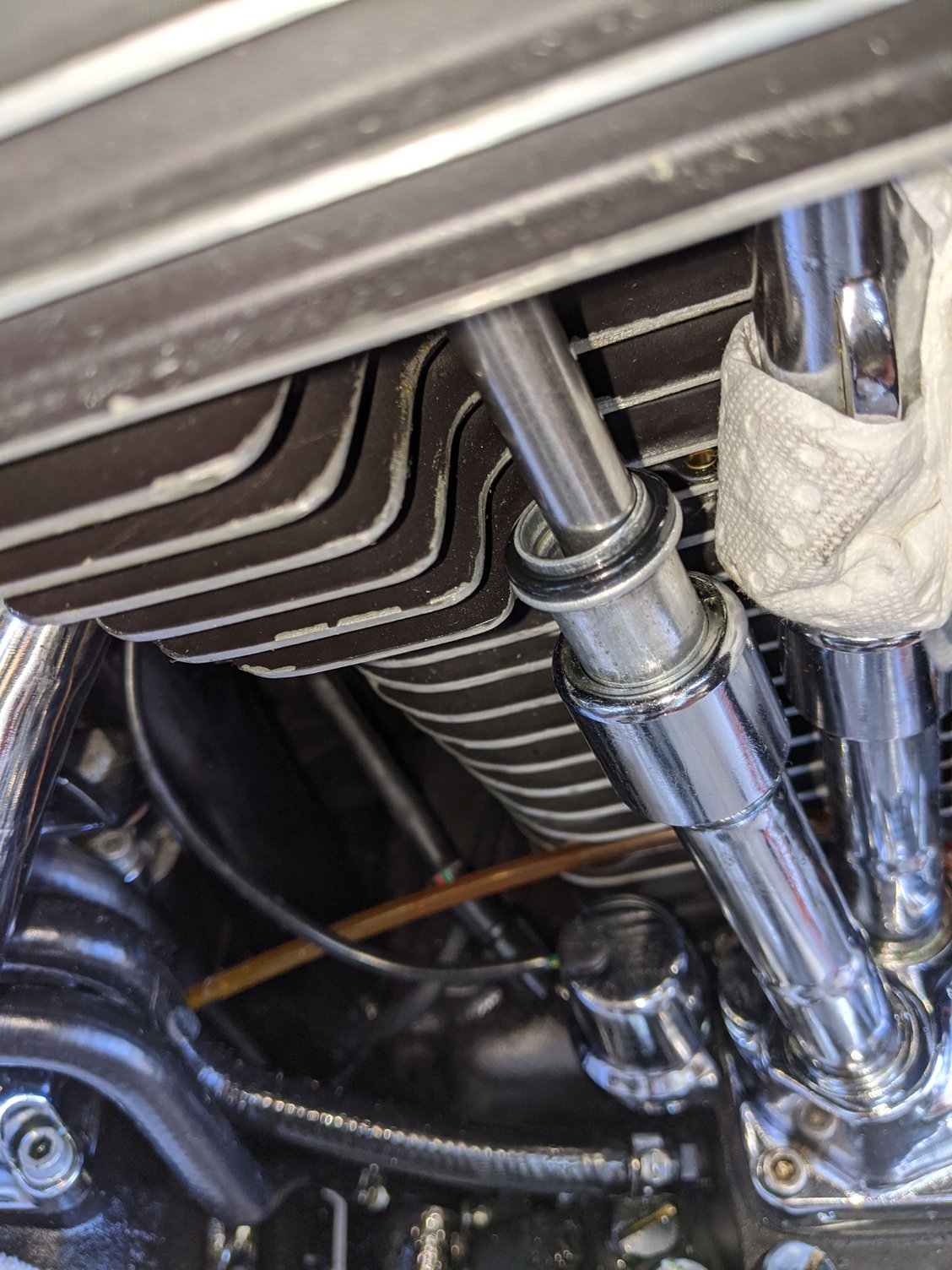

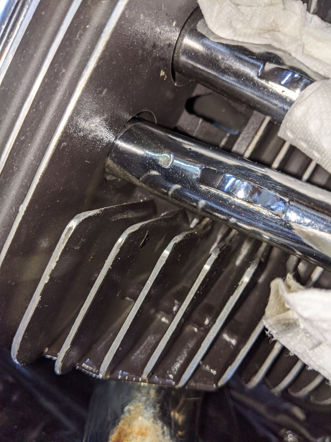

Went out again before work, put her on the lift to get a light and my eyeballs in it. It is definitely coming from the push for upper cover gasket. I know, I got issues.

If you've pinpointed to the O-ring in your heads, then that is a simple replacement with adjustable PRs.
f you don't have adjustable PRs, you can maybe reposition the O-ring (if not too damaged) and see if that would stop the leak. You can also replace the O-ring by cutting a new one 45 degree, slip it over the PR, glue it together, and install. This is the lazy, cheap person method. Of course the right way, without adjustable PRs, is to pull the rocker covers and replace appropriate gaskets. Your choice, and good luck.

O ring looks OK, but it fits real loose up top. Pop it in place and it slides right back out

Maybe it's just me but that doesn't look like the correct O-ring for the top of the pushrod.
