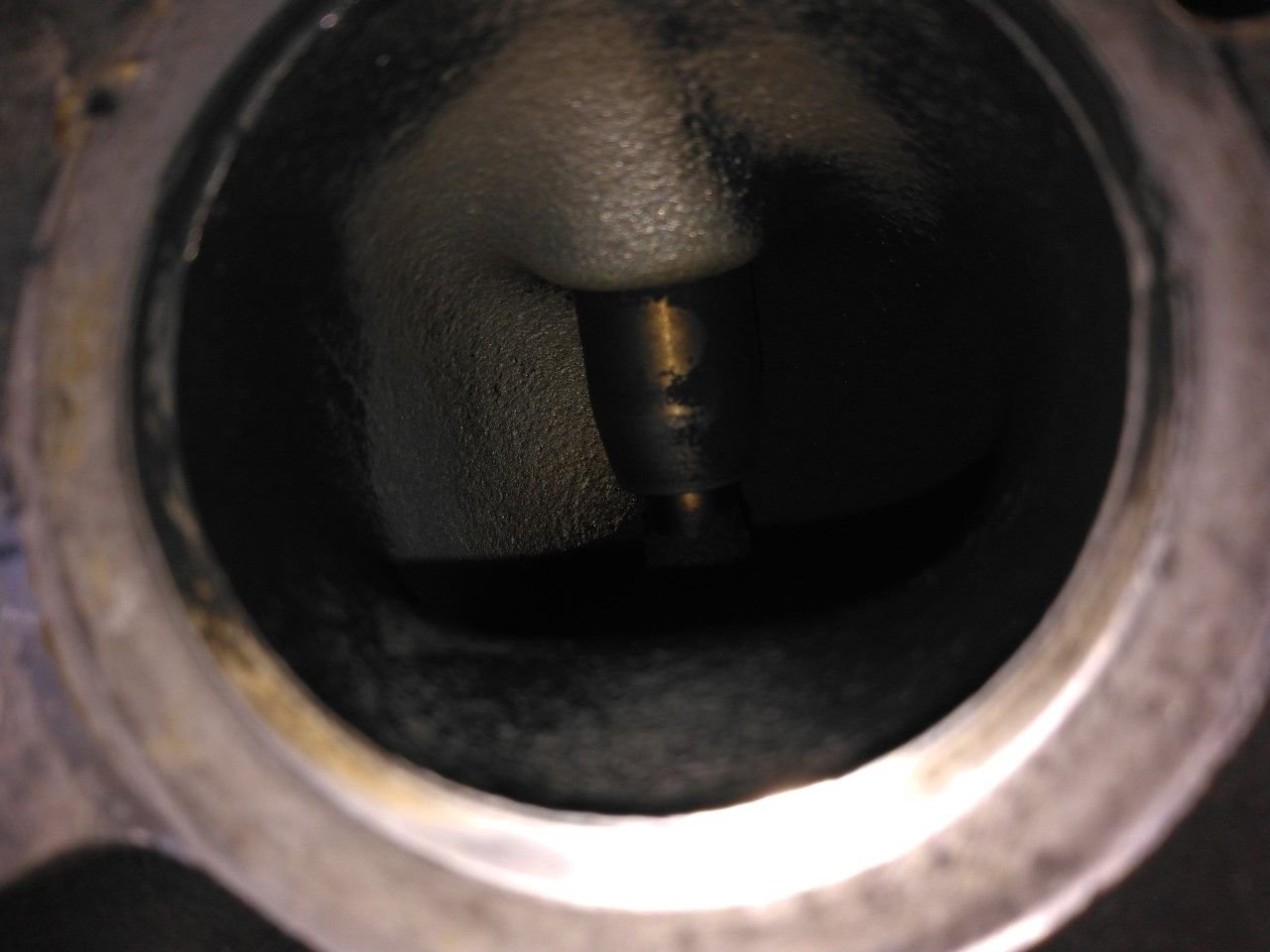

alright back at it today. finished up the wiring for the front end, headlight and directionals installed and wired.. replaced S&S G carb and intake with S&S E carb and intake. pics are not great but here is a peak down the intake holes in the heads
Front head intake
rear head intake
rear intake looking fairly carboned up.

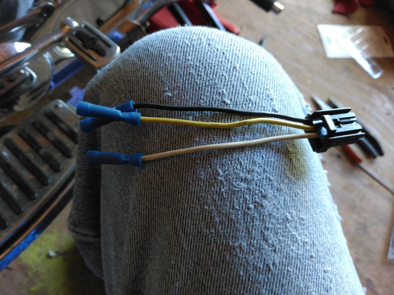

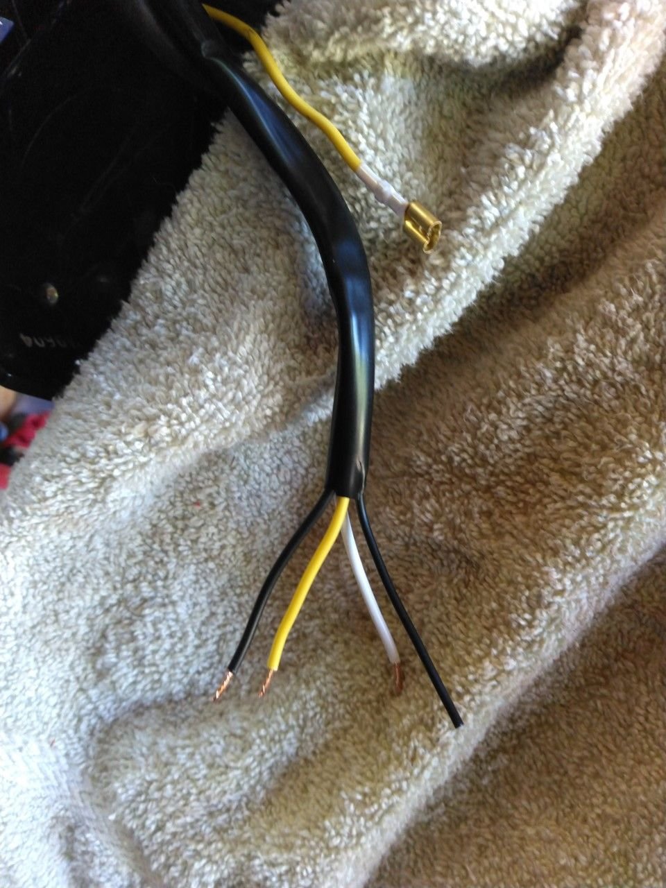

question for you electronic guys out there. I installed a new JP ribbed headlight with H4 bulb. it has extra wires coming out of it. what are they for? yellow wire with spade connector and an extra but smaller black wire.
I got it wired up fine and working, but what are these extra wires for?
JP headlight
the connector on the bike only has three wires
