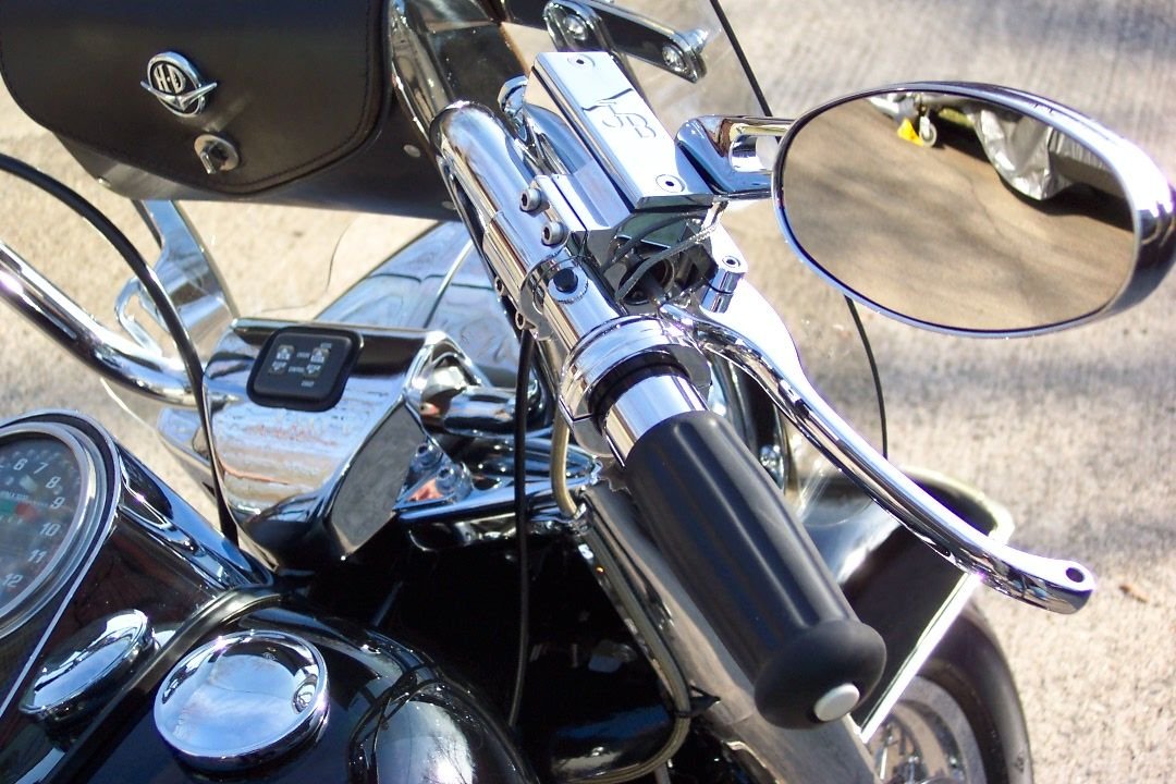

I've had the PM calipers on the bike since I built it back in the mid 90's, originally with the PM rotors in the pic. Warped the cast iron PM rotors, went with a inexpensive brand and they sucked, eventually went with EBC floaters which are currently on the bike. The calipers have never given me any real issues and use a single pad per side. I rebuilt them about 5 years ago for the 60,000 mile service. It's the master cylinder that's currently giving me issues, A J Brake 3/4 inch of the same vintage as the calipers. Can't get a rebuild kit from them as they are out of business. About 3 months ago the master cylinder stuck and locked up the front brakes, but I was able to pull off the road before anything dangerous happened. I found what was deemed a " replacement " for that size master on ebay, but it wasn't exactly the same. Piston was a bit different but did fit.
This is the culprit.
I removed, cleaned and rebuilt everything. All was working well until middle of last week when it started to build up pressure again. This time after searching high and low I actually found a correct reproduction kit with piston for the master cylinder. I plan on stripping everything down to completely clean and install new seals in the calipers and rebuild the master again. BTW, I've also owned a Thunderbolt, really fun bike and that gigantic rim mounted rotor really stopped for a streetbike. We ( guys at the Harley shop ) found with the right combination of bolt in parts we could get 90HP at the rear wheel. quite fun. Best handling " Harley " I've ever owned.
