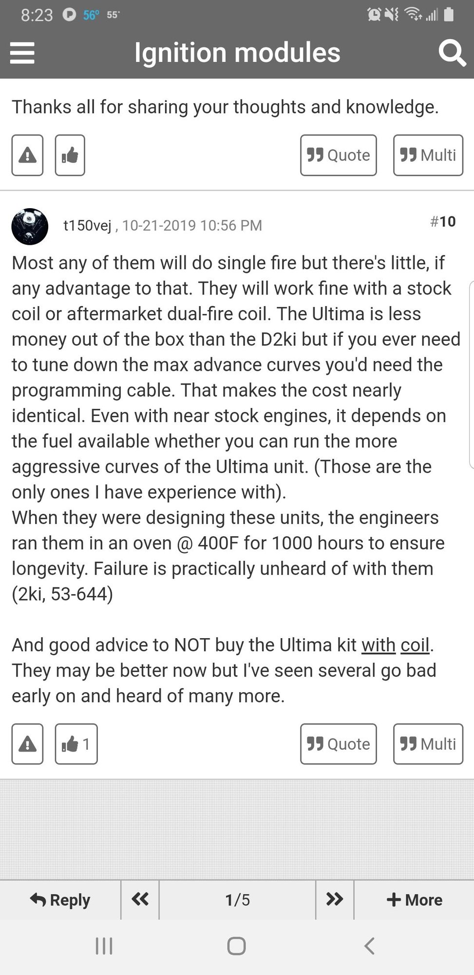

Took a screen shot of another thread talking about this and if your worried about heat I wouldn't worry to much about the ultima or 2ki
