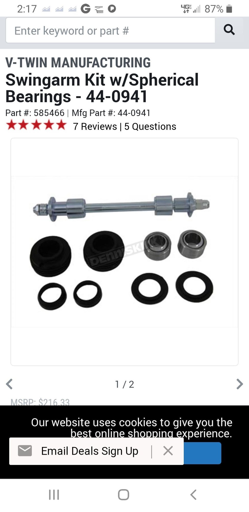

Thanks fellas, ended up getting a fake tool store hydraulic press...they were stuck in there pretty damn hard after 22 years
Went with the V Twin Manufacturers spherical bearing kit, will give my review of it once done...doing the ev13 cam too.
