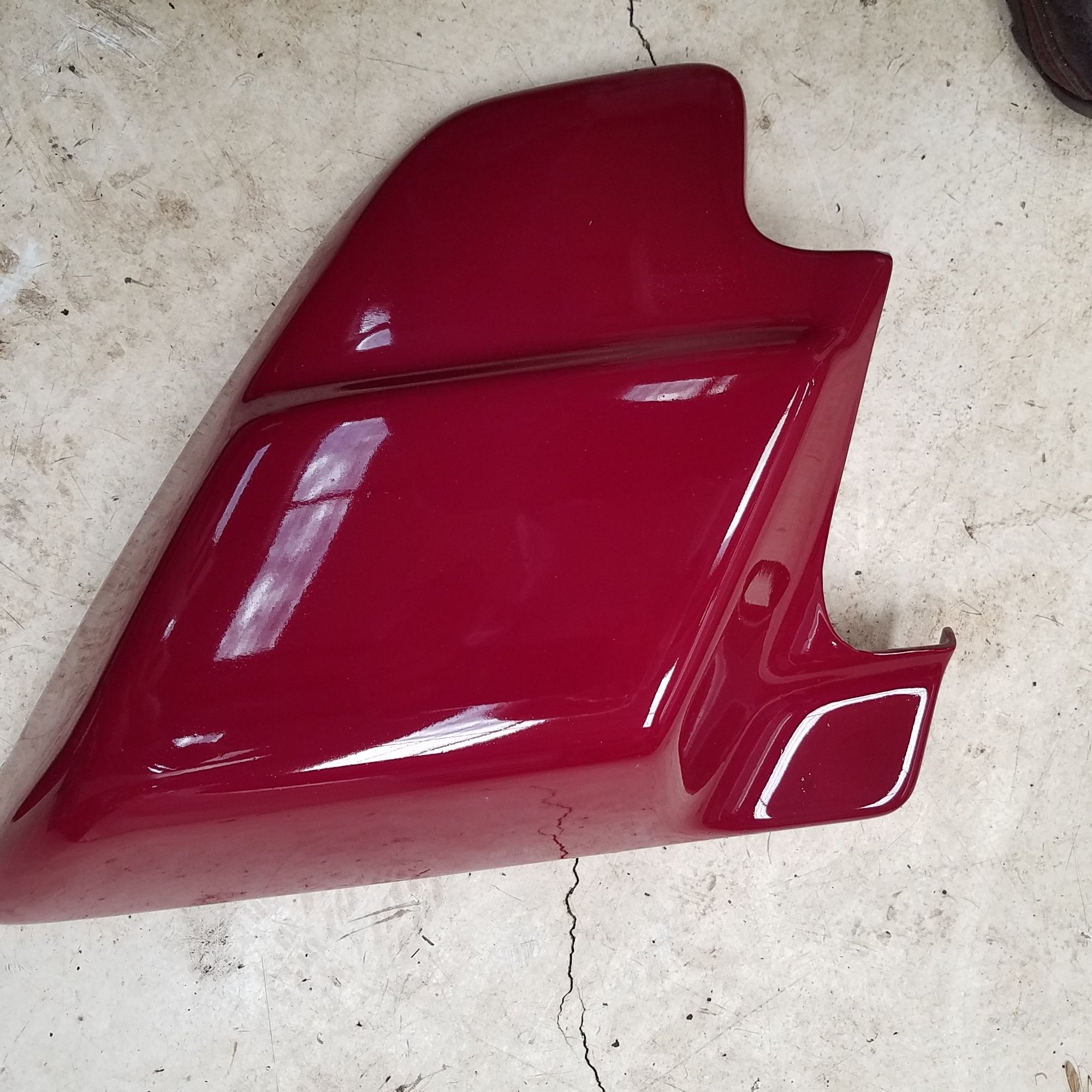

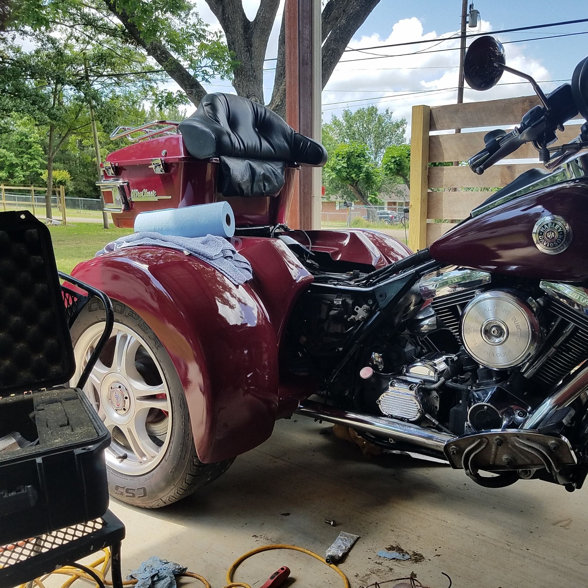

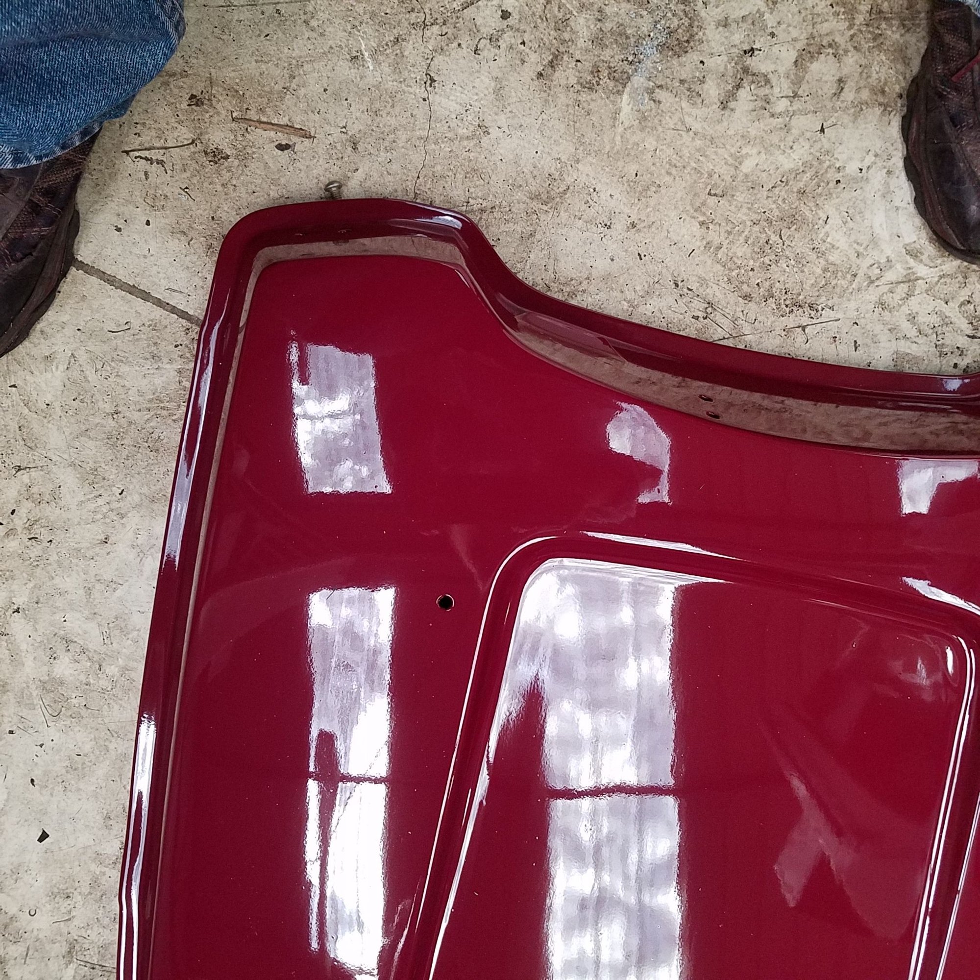

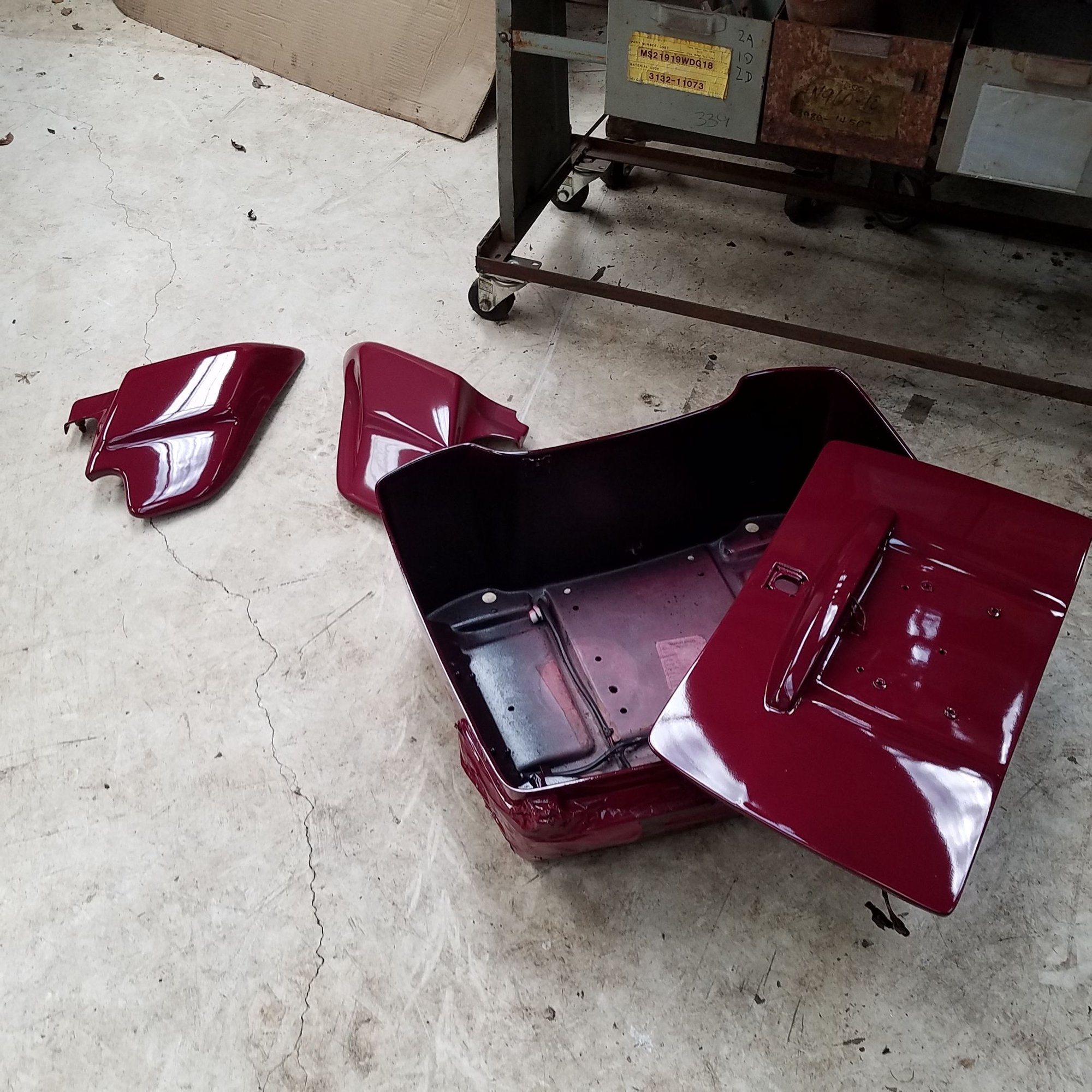

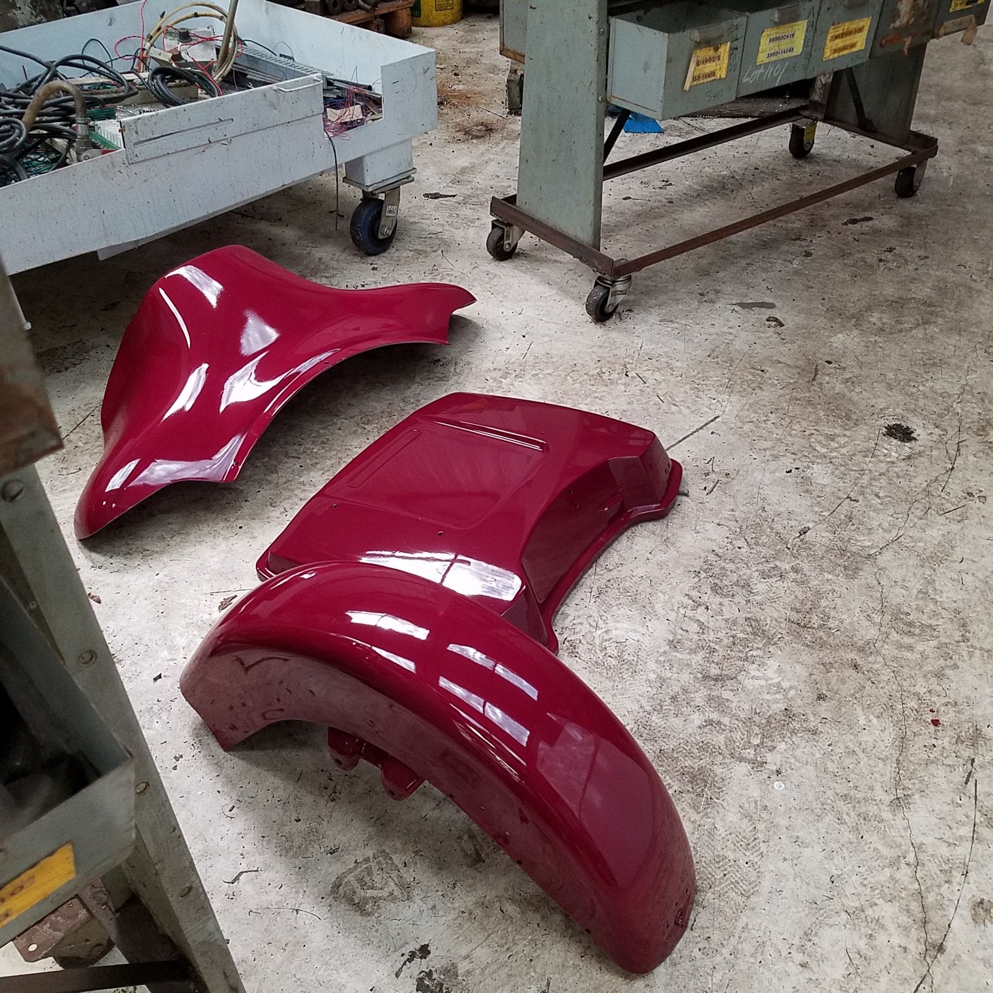

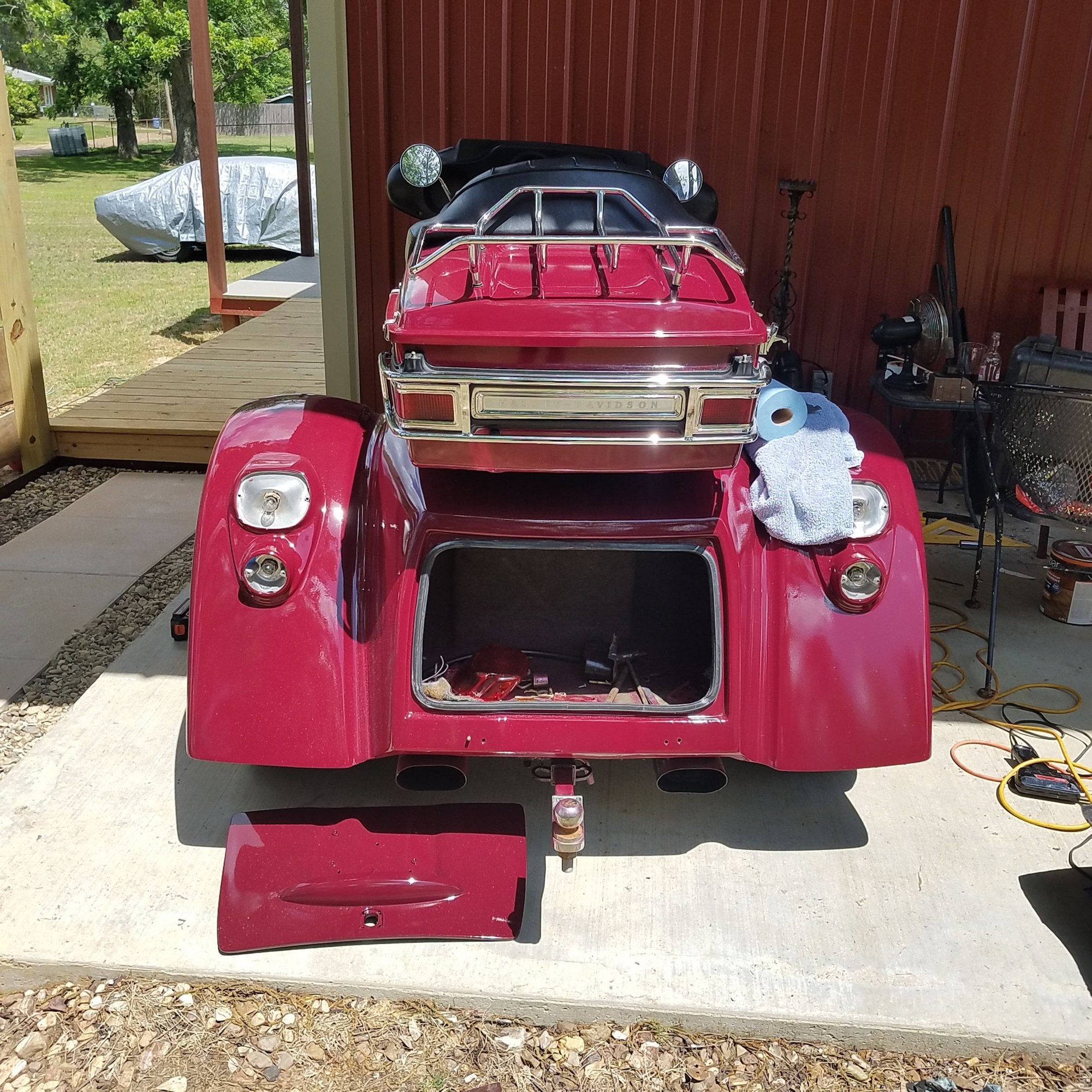

Finished shooting new paint on '98 Ultra trike last week. Labor of love, for sure...been down for a month and a week.
. Color is '49 HD Burgundy. Prep and disassembly was a bitch. Shot 2K polyurethane with an HVLP gun.
. Got tourpac together, mounted and rewired yesterday. Replacing every fastener with stainless steel. New tourpac latches.
. Painted frame satin black. Next is fairing, then trunk lid and fender. New brake, clutch, throttle, and idle cables. Replacing ***** in ramp with 10mm to gain a little more clutch disengagement.
. Best case, will be riding in a week. Ken
Trunk lid photo is best representation of true color.
