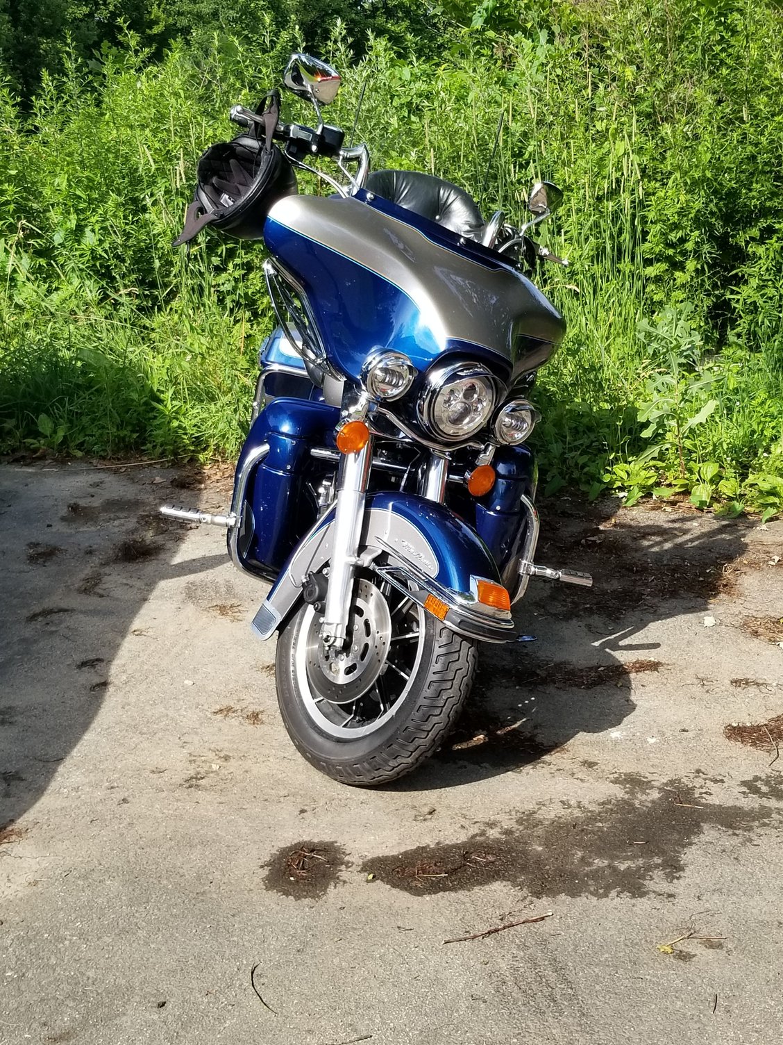

Thanks Im, most of this is already done on the throttle body side. New cables and gaskets, did not detect any leaks at the intake.
new fuel line o rings on order, will have to get the ones for injectors.
Will check fuel tank liner when I get into it, hopefully it's good.
The machine is in fantastic condition for its age, 45k on the clock. I am the 3rd owner, the guy I bought it off of owned it since 99. All work done previous to me was at an hd dealer. He took very good care of it, but there are many original parts that I have been slowly working through
New goodridge fuel lines and orings on order.
have factory service manual of course.

That bike does look to be in fantastic condition.
Please make sure to review the detailed list.
Many people have fallen into the head scratching and kicking dirt when something really simple like the CRANK POSITION SENSOR connector was loose and bike just shut down.
Documented after #8 in list provided.
Unusual that clutch went with 45,000 miles but maybe it just stuck together from not being ridden.
