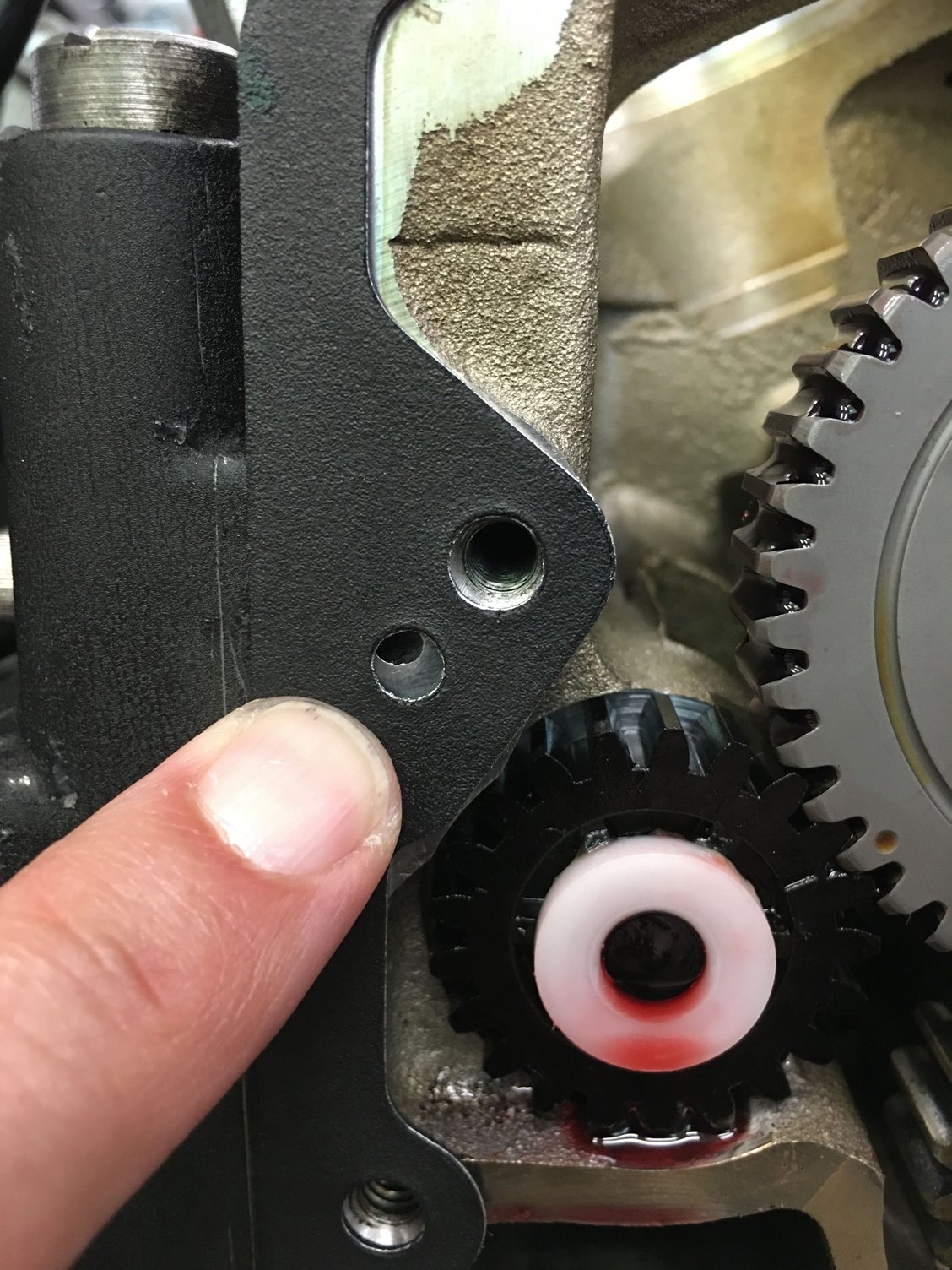

So, with the top breather gasket in place, everything lines up except this one hole. If I'm not mistaken, that hole mates with an oil gallery in the nose cone that feeds oil to pinion shaft. By the way, the bottom breather gasket, lines up perfectly here.
Do I leave it as is?
As a reminder, this is a Cometic gasket.
Old May 29, 2020 | 02:53 PM
TwiZted Biker's Avatar
TwiZted Biker
Joined: Mar 2009
Posts: 66,122
Likes: 51,434
From: Niles Canyon Ca.
Judging from that picture you want the other gasket, the one you have there is for this engine type,
