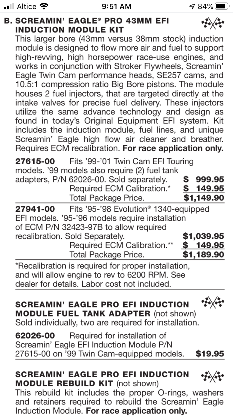

Originally Posted by Jagg11
I'll shave to see if I can find anything on that
There you have it.....one for EVO and one for Twin Cam. They worked well, but Delphi ultimately won.
I haven’t seen one in years......including EBay.
