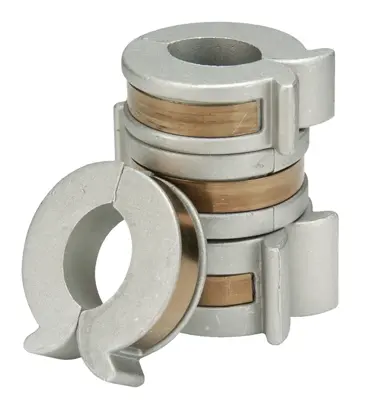

Originally Posted by Elecglide
What doen you mean by collar?
Do you have any pics?
They are called Stroke collars
not exactly what I used... but...like I said... PITA, tho Functional... If [big word] if you get the right size
BTW if the end of your shock is threaded/removeable, a heavy, washer is a plus!!!
