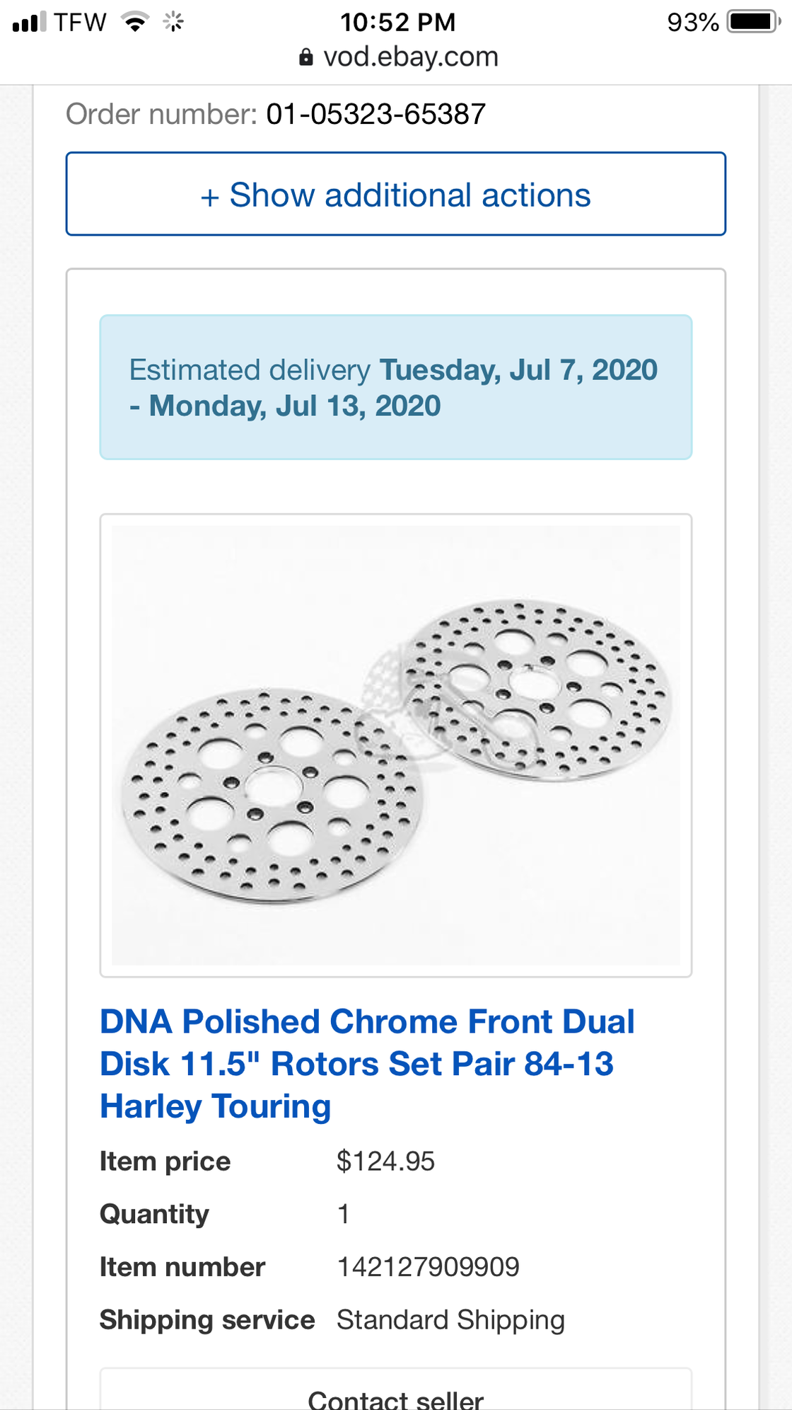

I ended up purchasing a new set of aftermarket disks. If I was a single man without children I’d say good enough and not think twice. But now a days I need to be a little more cautious for their sake. I appreciate all of the input!

You should have asked opinions on purchasing new rotors. Here's what I use..
https://www.jegs.com/i/Wilwood/950/1...hoCRwYQAvD_BwE
Could have saved yourself a few bucks I know what it's like to have a family....

Those adapter bushings are for counterbored aftermarket rotors ...like you'll observe when the New rotors you ordered show up
... (that's how they can advertise fitting 84-13 )
There are other adapter bushings that have No Step for what you were originally trying to do. They have a slight interference fit and are tapped on to the Hub Spigot for retention.
