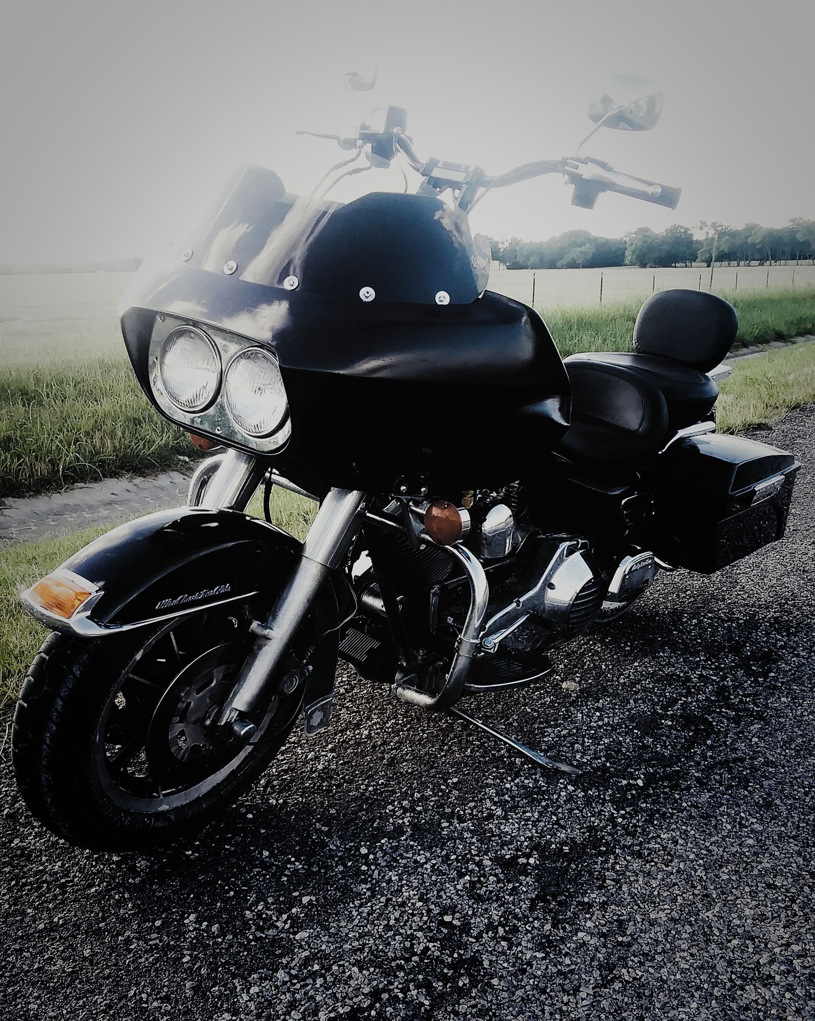

Recently picked up a 1995 tour glide

I changed grips and lost headlights/running lights. Brake switch is intact and operational. No pinched wires in housing. Brake light works, signals work, speedo cluster works.
I'm an old guy, this is by far the newest bike I've owned in a while and yes I've downloaded a service manual.
My question is this - is there a fuse/breaker/relay that controls just the headlight/running lights? If so where is it?

Really was just playin round with y'all, this bike is stripped down and barely resembles the ultra classic tour glide it left the factory as. Its had alot of hands in it in 25 yrs, nothing bad and mostly nice work. Its local and I knew most the history before I bought it.
Anyway, nothing under left side cover. Found short in fuse block nicely mounted and tucked under fairing.
Turns out it wasnt my doing after all.
