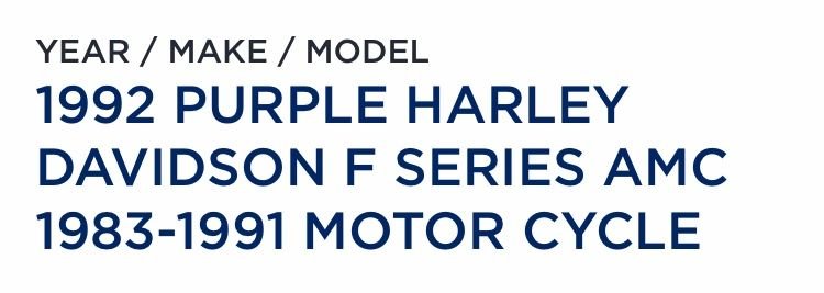

A stock configuration 1992 model did not have breather bolts. It breathes from the crankcase.
The registration has me confused now on what model it is
Use this site to decode your vin and you will know exactly what you bike is
http://www.harleys.de/engine.html
Doesn't really matter at this point.
You should have enough posts to upload pics by now. Post some, particularly of the spot on the heads where the carb back plate attaches.
