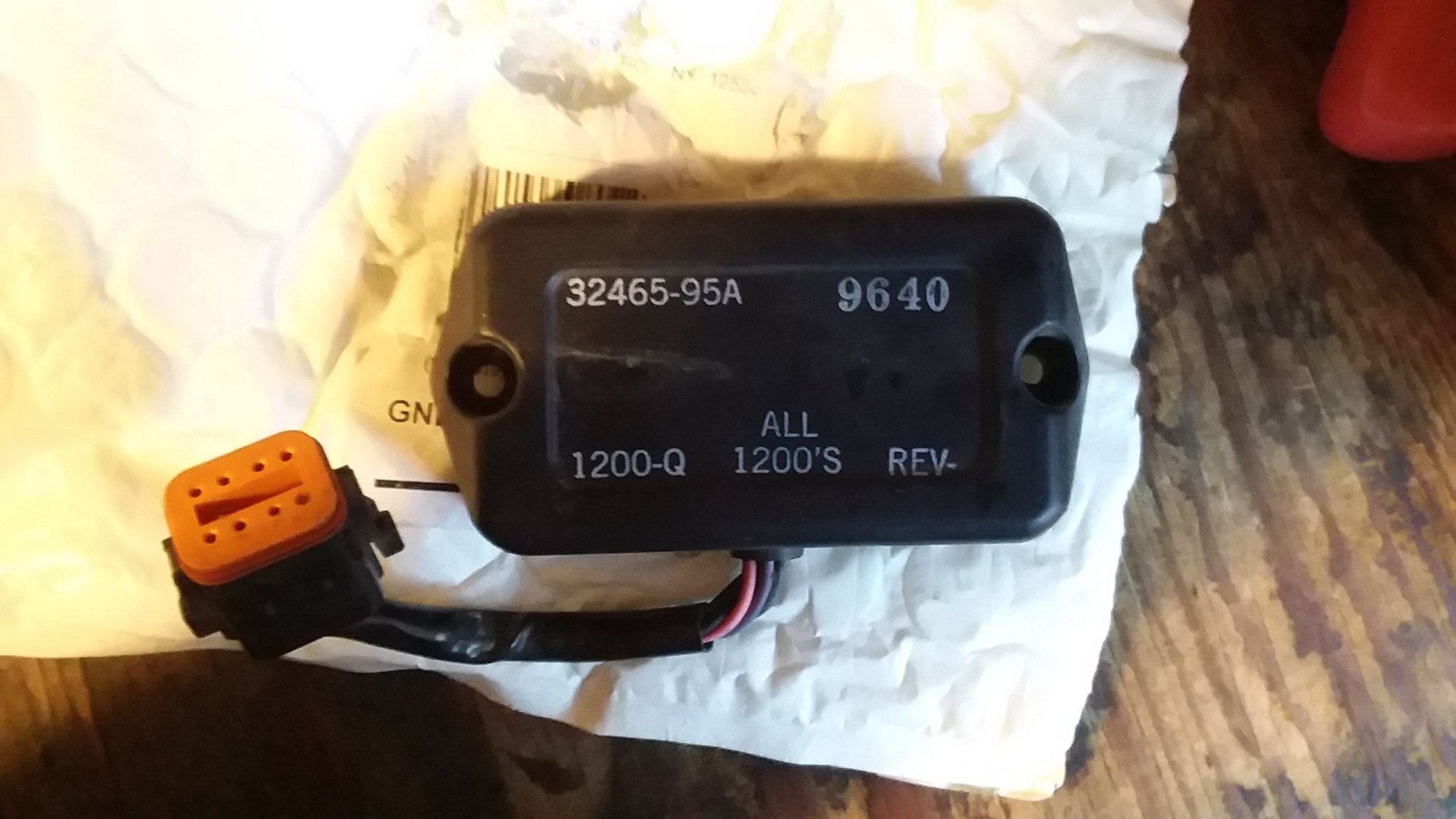

Does anyone know if this sportster Ignition Module 32465-95A will plug into a Softail.

As long as your 95 Fatboy has Duetch connectors it's a plug and play..
If your plug on your bike looks like thi
s it will.

Doesn't look like I have the right connector this is a 95 Fatboy.

There's an earlier Sportster module that should fit that. Look on ebay for one with a plug like that, or a Screaming Eagle with a plug like that. That is, if the module has that shape plug, it will work.

Seems to me even the very late Ironhead Sportster may have used that... Even More Aggressive...
I wasn't sure what year they changed the plug. Mine, as stated mine is a 99. I can't speak for any other module. Looks like a long night of searching for one that is equal to the 1200-Q

Probably:
https://www.ebay.com/itm/HARLEY-DAVI...temCondition=4
Certainly:
https://www.ebay.com/itm/Harley-Davi...temCondition=4
Here's a good one:
https://www.ebay.com/itm/Harley-Scre...QAAOSwoSxep3oi
Might work if you're good with wiring:
https://www.ebay.com/itm/1984-1995-H...QAAOSwu~5fHfXn
This one is probably exactly for your bike:
https://www.ebay.com/itm/937-94-HARL...EAAOSwBqpfR93V

Dang Dr Hess looks like the plug I need is available. Thanks for the good information. Now I need to decide if a stock screaming eagle ignition module for a fat boy has the same curve as a sportster screaming eagle ignition module. This would be something I can throw on in 5 minutes while I'm waiting for cam replacement parts list.
