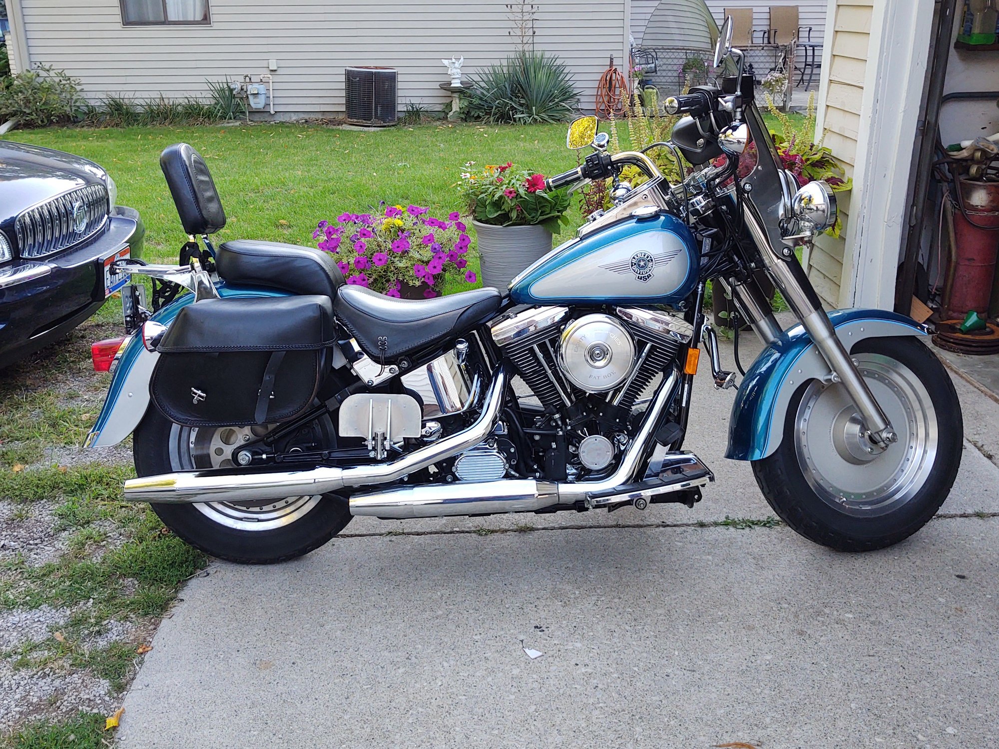

I think the sportster ignition module made it run a little better. Installed the EV13 CAM put the 04 heritage oem exhaust on, way too quiet, probably too much back pressure also. Put the long shots back on and now looking for baffles.

Pipes looked ok but I could hear the tires rolling down the road..

I put about 50 mi on it yesterday. Seemed to have a little more power check all the bolts everything still tight, no leaks. Probably should have done more research ev23 might be okay. I have 46 and 180 Jets going to put some miles on and check the plugs.

Big City thunder baffles installed. Sounds pretty good can't wait to go for a ride. I'm going to try and make a video with sound.
That's a fine looking motorcycle, right there. We don't talk about it enough, but the MoCo had some awesome paint colors back in the Evo era.
