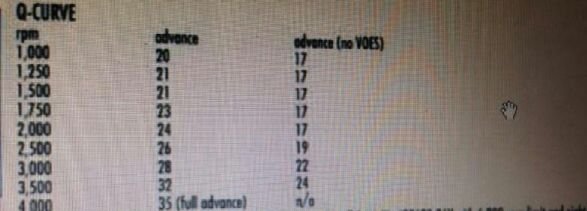

But, I'm not sure if your ignition will plug into the Harley Q module but I recommend using it, I and my son in law use it. You can find them on Ebay used. They come out of the 1996 Sportster and a couple other years. It has a 6200 red line and won't advance at 4 grand more then the stock you have now, so it won't cause over heating issues running on long rides being advanced to far. Plus it has a slow advance giving a smooth acceleration and wards off ping when lugging, it's not advancing to fast. Its fully advanced at 4 grand just like the stock 80" module so it makes a perfect swap! It made a difference in both our bikes. I don't remember the part number just remember the Q on the module and 1996 sportster. Check the plugs to be sure they are the same for your year.
Here is the chart showing its advance. My son in laws bike when stage 1 at the time fought its self to cruise 80, after the change it cruised 90 effortlessly.

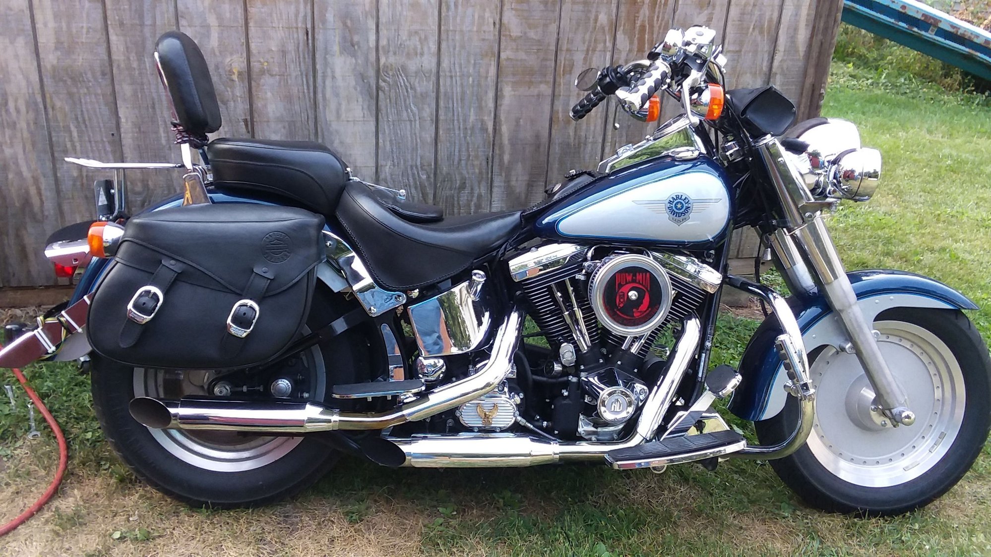

my bike
