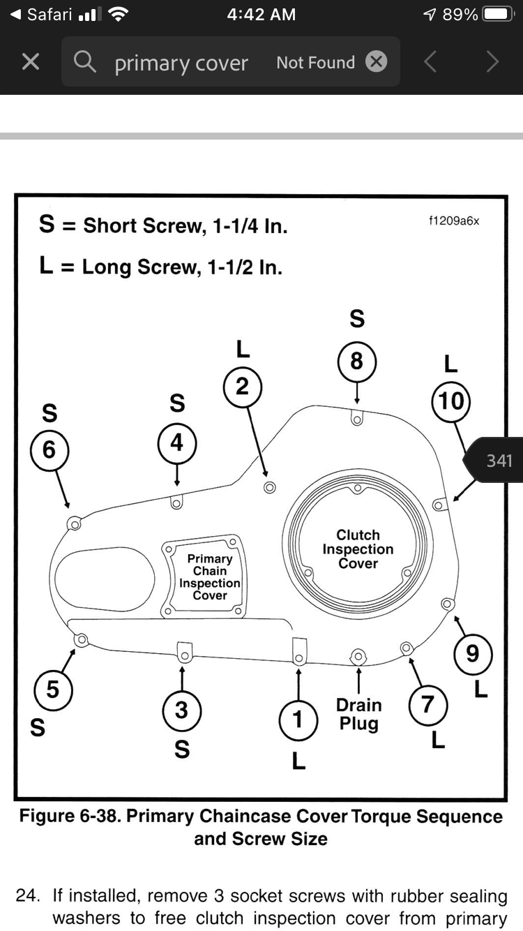

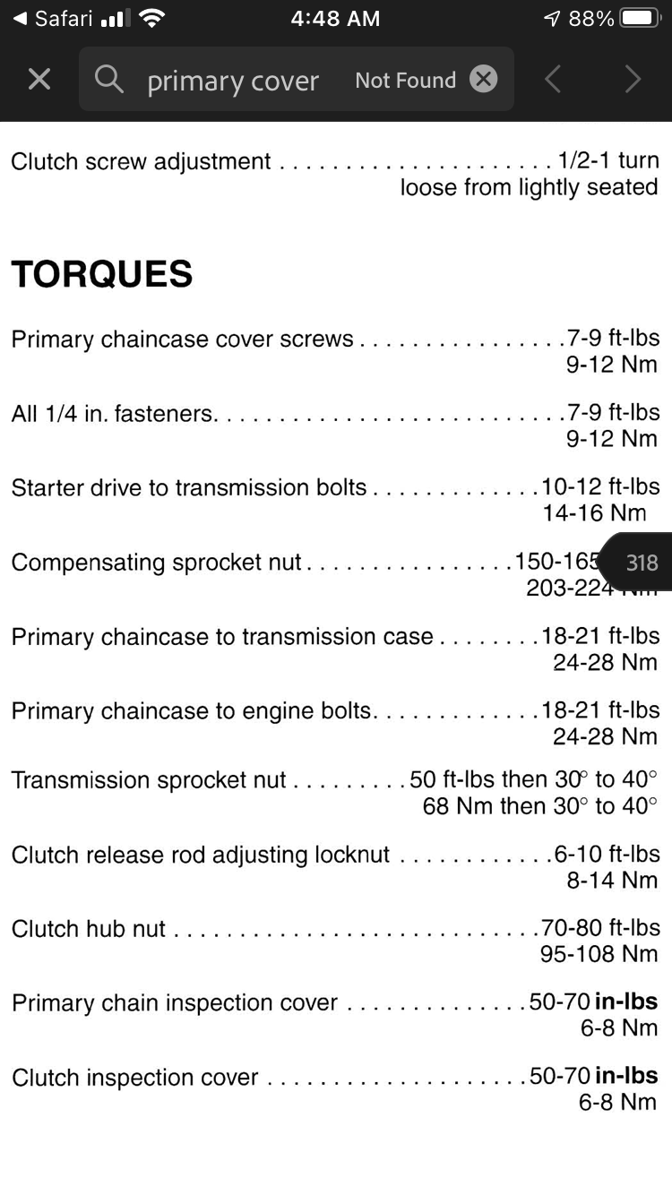

or 84 inch lbs. to 108 inch lbs. As I said, I don’t use a torque wrench on these.
But, if a person chooses to use the torque wrench.....follow the guidelines, verify the torque wrench is accurate, and verify the settings on torque wrench.
