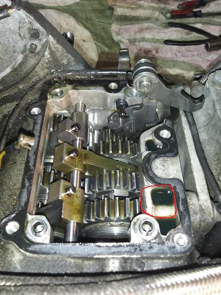

But if your buddy will give you a deal on that baker OD6, then ??? the only issue I had putting a OD6 in my transmission case on my 85 fxr is I had to do some clearance on the top inside of the case to make room for the bigger shift drum detent here in the pic
With that being said, is there a case that I could use that would bolt up to where I wouldn't have that problem? Sounds really convenient to be able to just bolt up a '98 trans with the updated primary ect.

No I don't know of a direct replacement case that will work for a six speed with no modification, because of the rear transmission mount, the way bolts to the engine and oil filter screws to the bottom of it, It wasn't any big deal to cut and grind out this section with the gear set out, the newer transmission cases don't have that section but they don't have the right rear transmission mount either and I don't believe the oil filter mount
