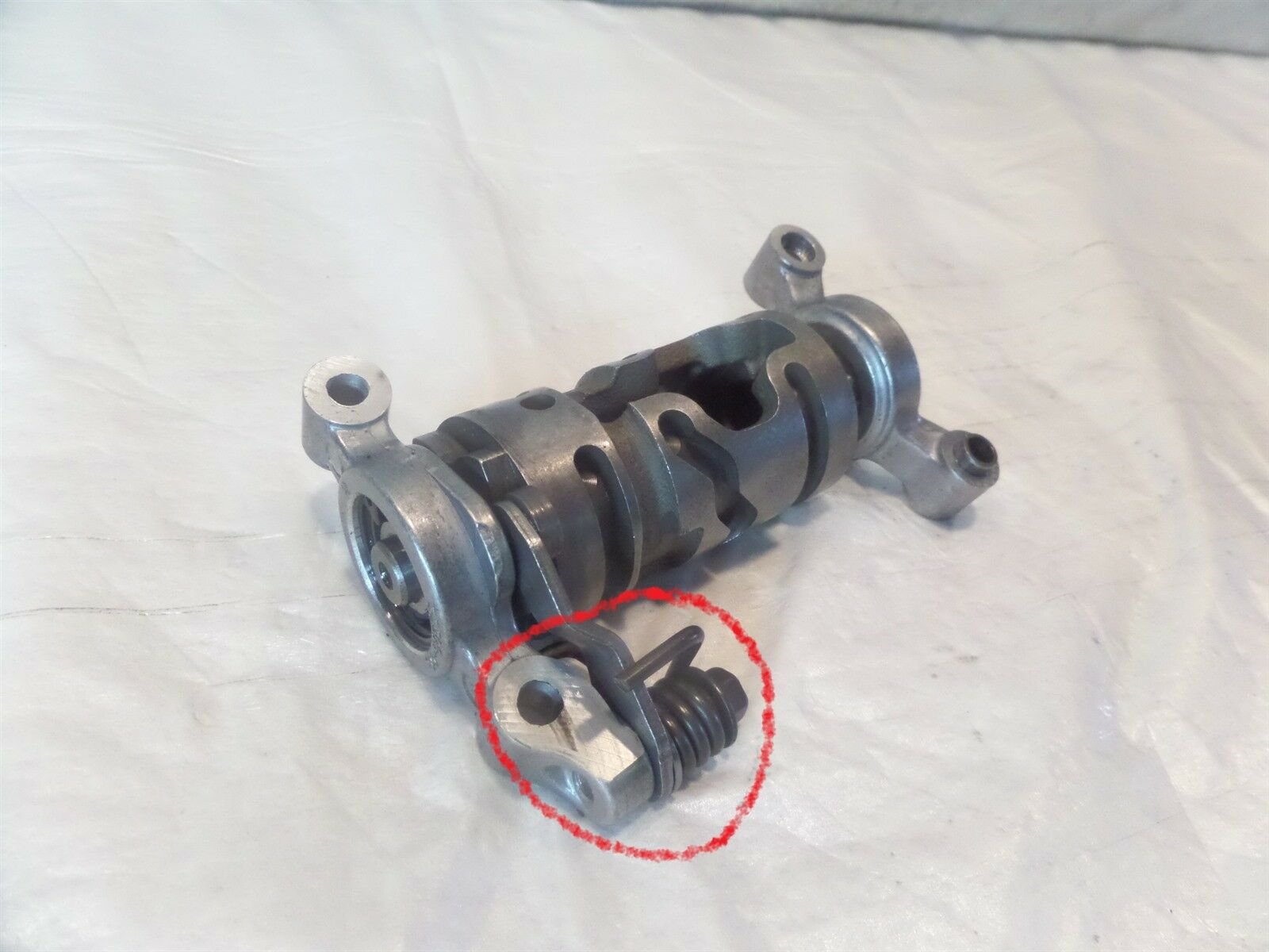

this is what you have to do the clearance for shift drum detent

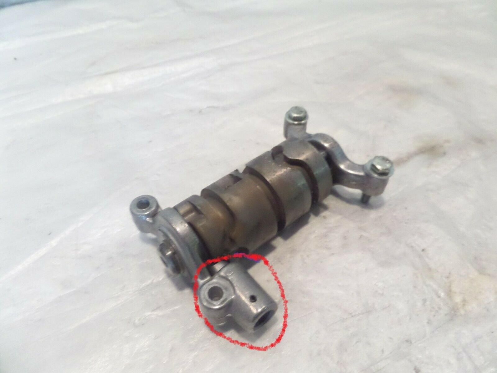

your bike will have one like this, the newer 91 and up 5 gear sets like Dan was talking about will have a detent like the first pic and you will have to clear for it, but you maybe able to use your old shift drum on a newer 5 speed, I don't know maybe Dan does or I think you can get a shift drum with the small detent
it that will work with out having to clear the case

Either shift drum will work, but the correct shift pawl/shaft assembly must also be used.
When I installed the late model shift drum into my `89 case I had to remove some material in the area of the spring, but it was about a 5 minute job.
The late model shift drum with the roller detent is a big improvement over the old type spring detent.
My `89 transmission case has a `99 gearset from a bagger, and a shift drum/pawl assembly from `05.

Your `88 transmission case will accept any later year OEM 5 speed gearset with no modifications. Plug and play.
You don`t need to use the newer model shift drum.
If you fit a late model roller detent shift drum you may need to get your dremel out and remove a small amount of material in an easy to get at location.

You need to take your top cover off you tranny and take a look at it and see if its like mine which I believe it is, if so all the six speed gear sets I've seen have the roller detent and will have to be cleared in my pic, or use a 5 speed gear set with old spring detent, I don't think you will find a newer transmission case that will bolt up with out alot of modification??
