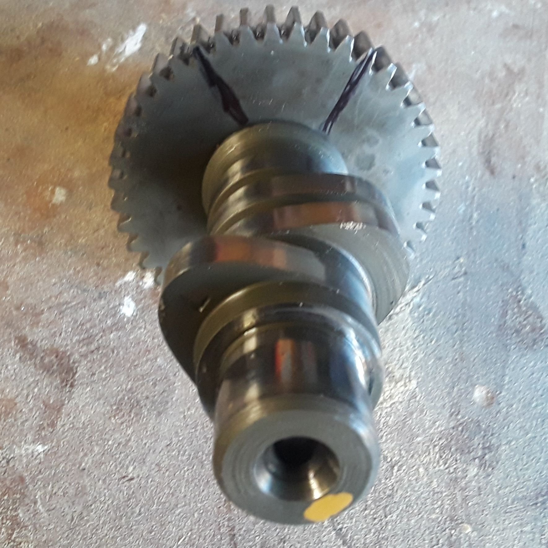

Old Nov 15, 2020 | 04:49 PM
0maha's Avatar
0maha
Joined: Nov 2012
Posts: 6,555
Likes: 4,798
From: Omaha
Here are some pix that may come in handy.
This is an OEM cam+gear from a 1990. I marked the teeth that have the timing marks, then extended those to the reverse side. If you're concerned about the installation of your cam gear, you can use this as a reference. The lobes on yours (even if aftermarket) should be at least in the ballpark of this.
