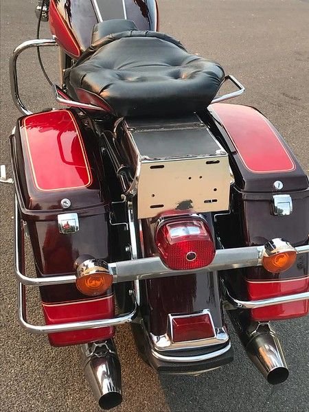

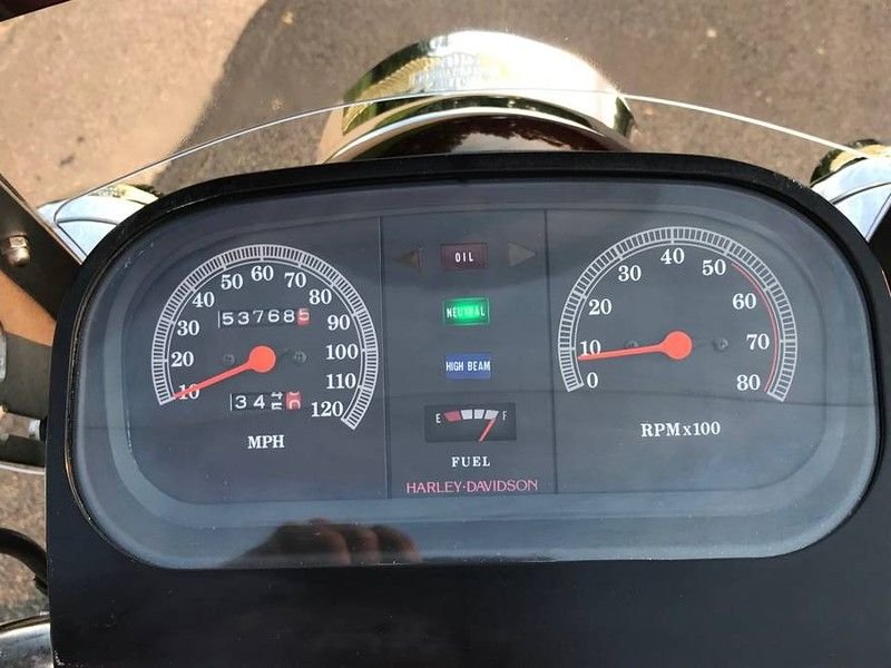

Owner is firm on the price of $3995. Has 53K on the clock. Only mods are the mufflers. Ad doesn't say anything about cam bearing change. He also has a tour-pak for it. No oil leaks & everything works. It is out of state so there will be a shipping charge.
I like the FLHS models. Just a basic bagger with a couple of gauges and no frills. (The live to ride stuff has to go.).
Anything about the year model to be cautious about?
Worth the price?

Looks good. I like the two-tone paint.
Wouldn't sweat the cam bearing on a '90. It came from the factory with the good one.

$4000 for that much iron. Here in VA, you can run antique plates. Never need an inspection, no taxes, and never renew state or city tags. It's pretty. If it runs good it needs nothing for 150K. Leave it alone and drive it.
That gold option is hot on an antique.
If you are trying to roll it, now that is something different.
And I would have to check it out and if shipping, I would need to be there to get it on my trailer. I bought a good deal and it turned out to be stolen. My caution and checking saved me some big dollars. Even owner and bank didn't know. Plus now days, scams are big-time.
