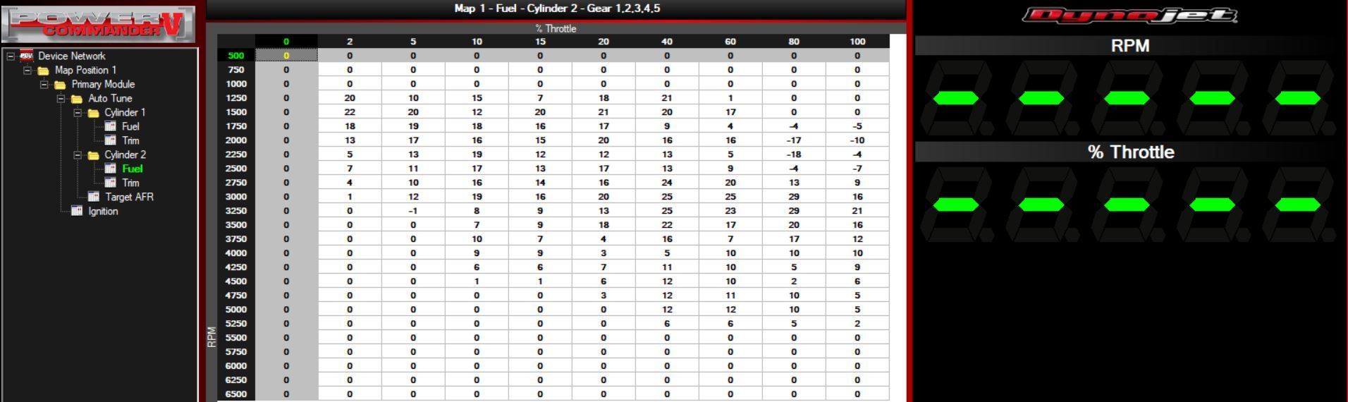

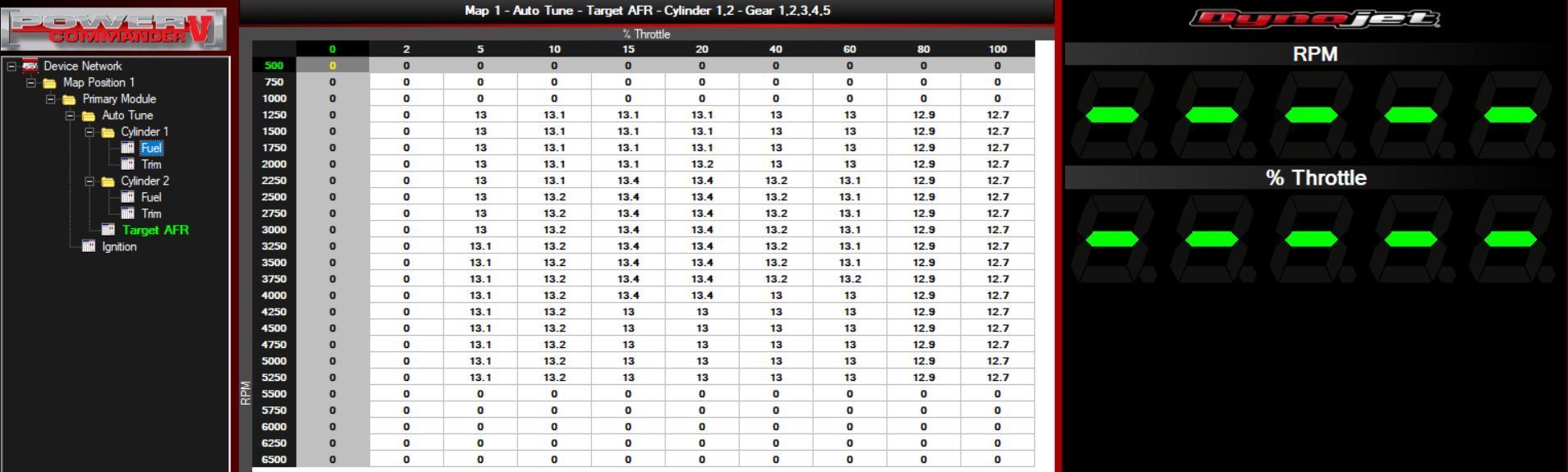

I have the Power Commander V, auto tuner and data logger display. This is my target AFR, I set it where I want it.
This is the fuel that is is adjusting on Cyl 1 to get the AFR
This is the fuel that is is adjusting on Cyl 2 to get the AFR
This is the timing adjustment to avance or retard
If you build your map based on 1 cylinder, then then the other cylinder will be off on the AFR
For fuel injected yes, you need to do both cylinders.. However YD wants to wide band tune his carburated Evo...

Putting just an opinion to the side the auto tune looks like a good system and showing the operation of a EFI map, gives Evo members a good idea how a EFI map is set up and makes adjustments. Auto tune graph is showing the front cylinder is putting in more fuel compared to the rear with adjustments meaning it is leaner confirming the front cylinder on a Harley runs hotter against the theory of lack of air flow to the rear cylinder. According to this information you posted tuning a carb off the front cylinder is the proper way to tune the prehistoric dripping device. Have heard a few engine guru's speak about the design of a Harley engine runs richer on the back cylinder, have heard the back cylinder runs hotter(leaner) from lack of air flow, your graph confirms the front cylinder runs leaner and good to know.

No comment about which cylinder gets hotter- there are ways to measure that, if you wish.
The numbers are different, because you're starting from different baseline points. Look at the factory/SE/PV/TTS maps, and you'll see VE values vary, front to rear., so the amount needed to add would be different.

I'm running 10 to 1 pistons and EV 27 cam, can't lean it out much more, That is my summer tune, I can go a little leaner in the winter.

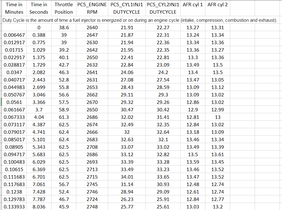

This is 8 seconds of a 15 minute log...

Your verifying Harley engine cylinders run different VE's needing different fuel amounts added correct? Kinda my point

Where's the fricken 100% throttle and revlimiter run? this about put me to sleep
It is good information tho
