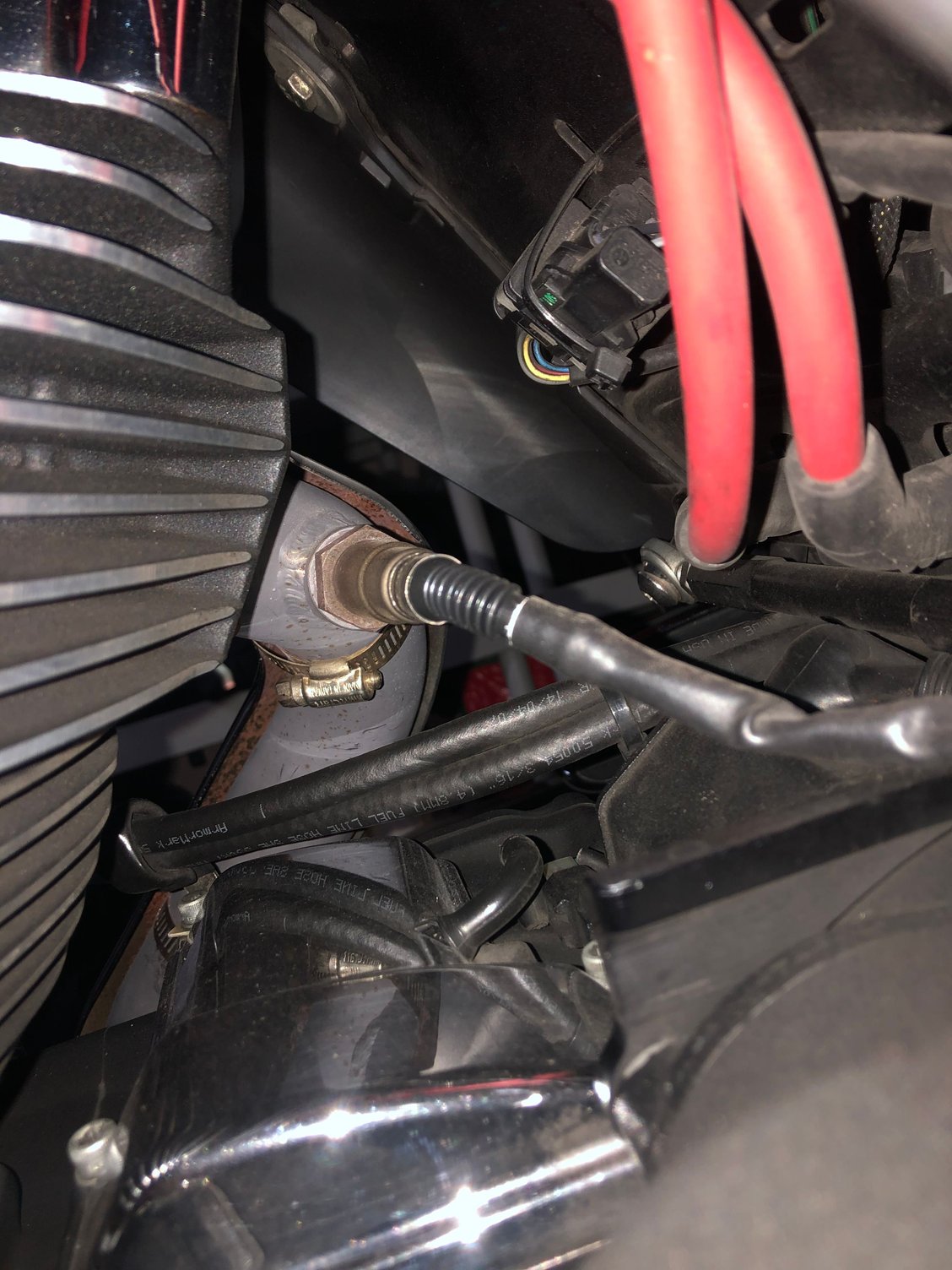

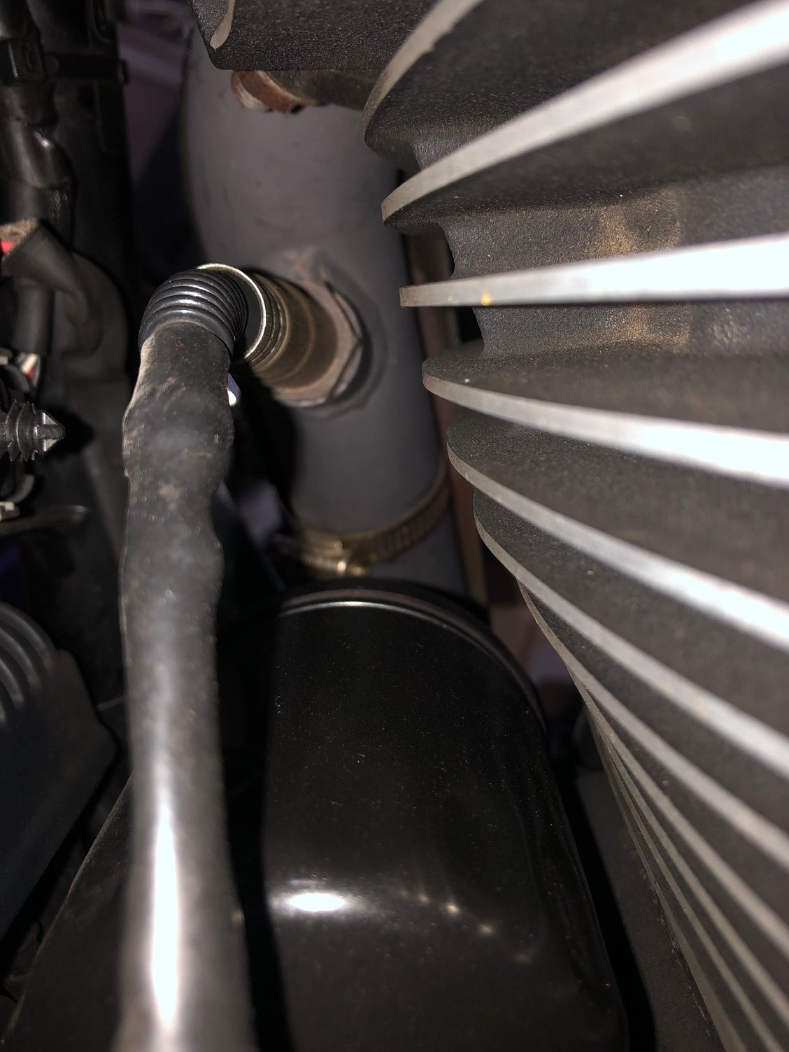

3 to 3.5" down the pipe from the exhaust ports.. Both of the should be pointing to the primary case side of the bike... I'll try to get pics..
Front cylinder
Rear cylinder

Perfect! Thanks for the pics.

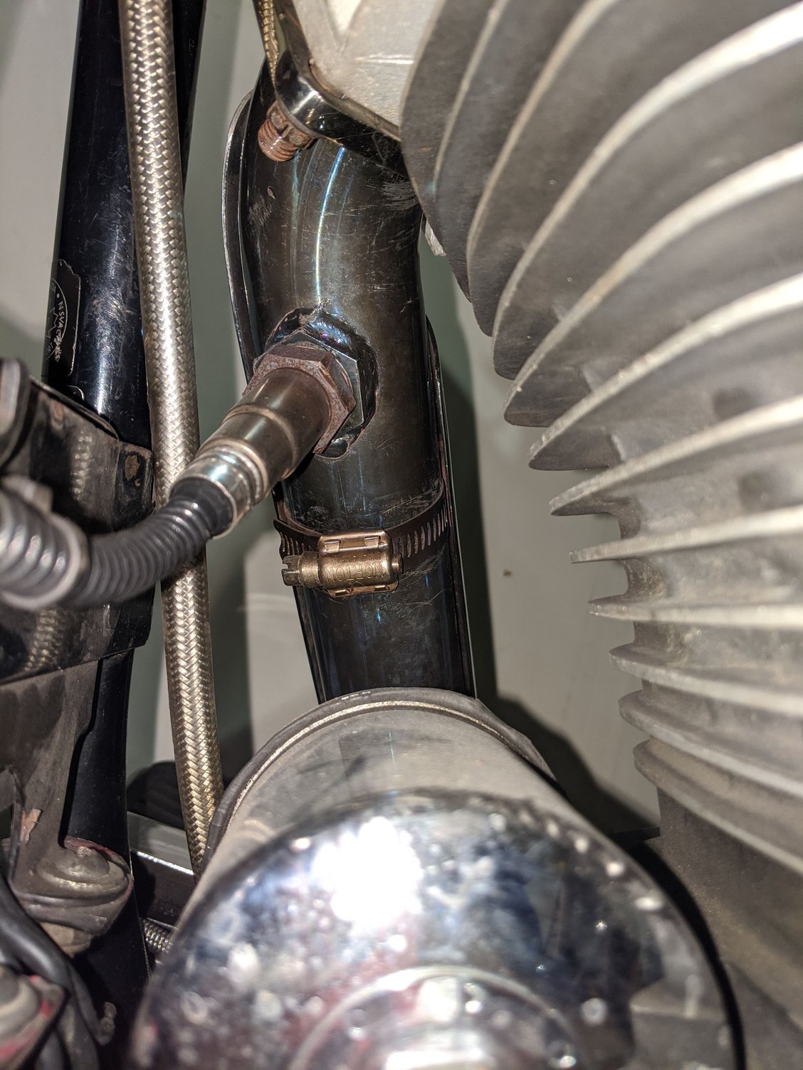

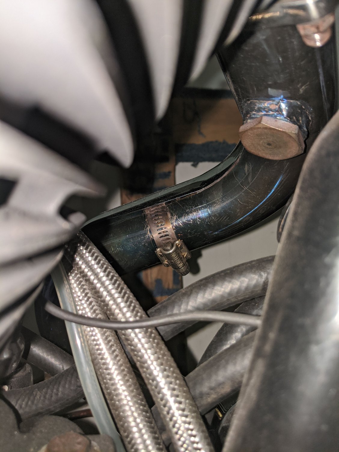

Yes, that was one of my concerns. However, I was limited with my location choice. I was looking for a location where I had room, away from other heat sources, out of the way and non obtrusive, would not interfere with access to other things like oil filter, trans dip stick, etc. Front bung is 12 inches from head, and rear is about 6 inches from head. You can see in the pics (below) the locations.
Front has the sensor installed, rear is the bung with a plug in place.
Not sure if the locations are going to be a problem with moisture, but I used my old set of head pipes for "practice". Just did a quick MIG job on the bungs. If the locations work out, then I will have stainless bungs TIG welded on to my "good" (NOS) head pipes. If the locations don't work out, then back to the drawing board.
Hope to get wiring done this weekend.

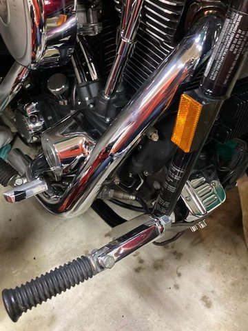

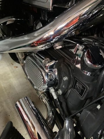

Not too many options with straight bungs, angled bungs gives more options and is used on most head pipes.
https://www.bmotorsports.com/shop/pr...CABEgK_hfD_BwE
This is a Bassani head pipe on my TC. slight angle down above oil filter
rear

Yes, I can see from that pic how angles can help. Thanks for posting.
