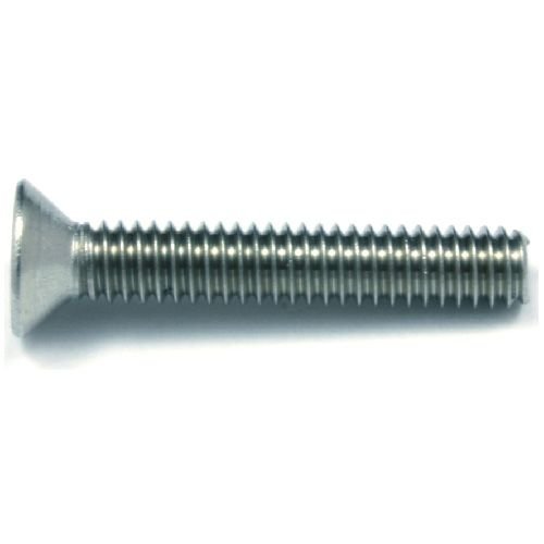

I use a flat head 1/4-20 bolt as an alignment tool and you can get them at your local Ace Hardware
That's all I did also, worked fine.
