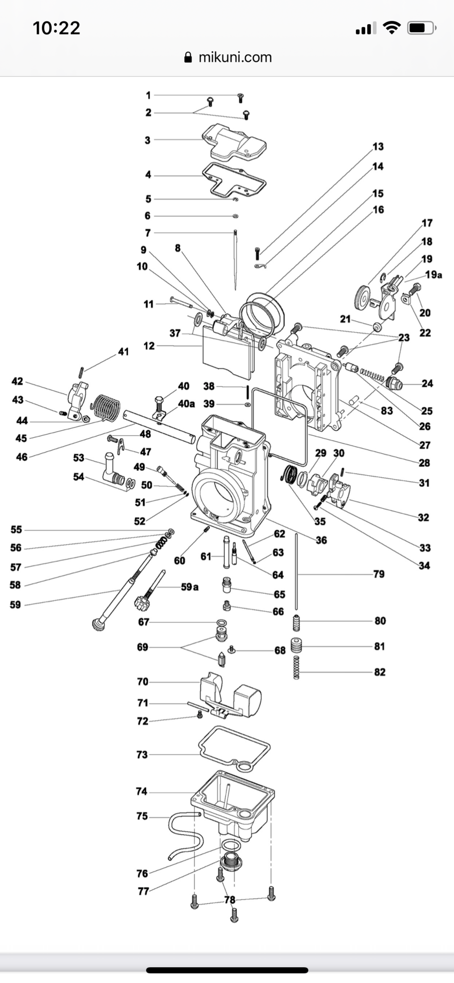

It’s a HSR. I still don’t see bearings of any sort for the slide operation. Here’s pics from the manual showing all the parts. I don’t see any listed there either.

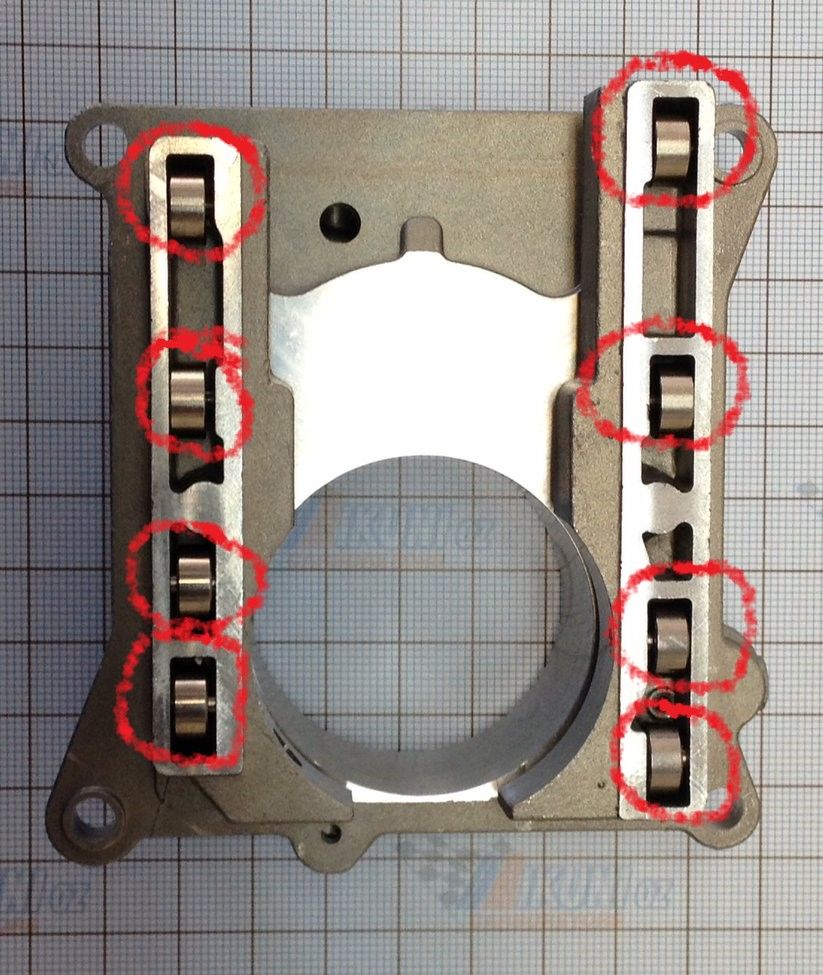

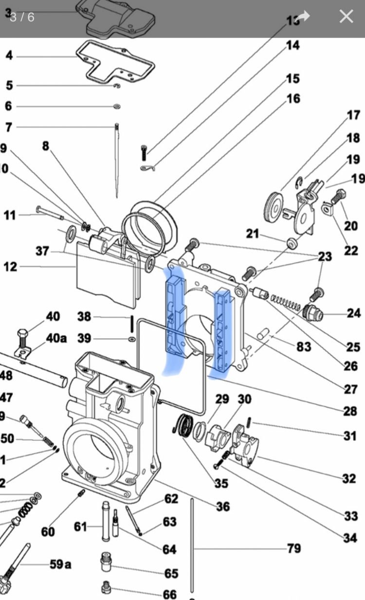

No I`m talking about the roller bearings of the HSR......I am somewhat stunned people think Mikuni is selling thousands of their carburetors for years as described in the ads above, and they could still today get away with selling them without the rollers and cheating everyone... ?
Well...ok...why not, Lectron is saying their carbs have a "idle system".... go search for it......I did....but "system" is a flexible term...
BUT .... different on the Mik... .. the throttle valve is guided by eight rollers as they say ....
Originally Posted by Architect
I rebuilt mine 2 seasons ago, no bearings inside.
....My best guess is you did not see bearings on parts you had removed, or just did not look for some... they are not on the throttle valve or loose parts like ***** falling out when disassembling or so, maybe that`s why you did not note them....
Originally Posted by Jake707
My mikuni def is just a slip fit in a track for the slide
....you are not able to spot the roller bearings from outside.......it would need a full disassembly...
....this is because sometimes parts are just not on parts fishes, sometimes not available (any more) or like in this case, not available separately....
The roller bearings are part of the body (not part of the throttle valve) , more exact one part of the body - it`s # TM42/06 on that fish.... you can only spot the rollers on the fish drawing if you know how they look in flesh....
...when disassembling the carb like for cleaning, you don`t split the body usually.....
