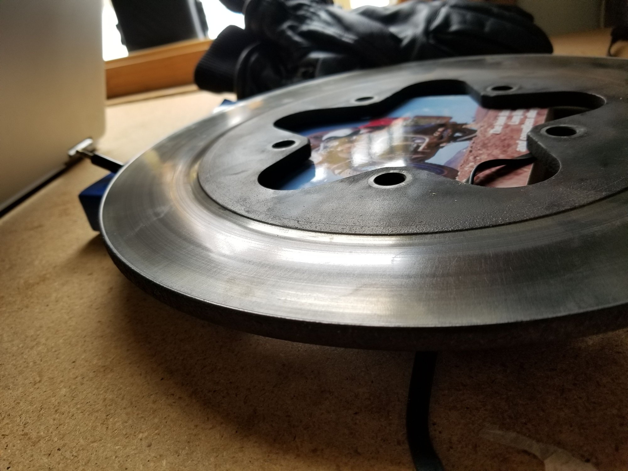

Not too bad just thinner than it should be

I'd run that one and feel real good about it

Just how thin is it ?? That doesn't look all that terrible

its cast iron stock, i measure .25 and its stamped .27 min, so I reckon that answers my question on that, but the stainless products must be different? Still researching.

If that's all it's under
I'm with t150vej I'd run it without a doubt

Again, I wouldn't even consider replacing one that looked that good...

Well I reckon I will hold off on the rotor, and continue running my rear pulley that has lost most of its wear surface plating, but is is good shape otherwise, nice and round teeth.
maybe next winter I will feel different, hopefully after quite a few miles racked up.
Sounds like aftermarket rotors can work but stay away from aftermarket pulleys is the consensus. Thanks for your time folks.

Yours at.250" is fine....
