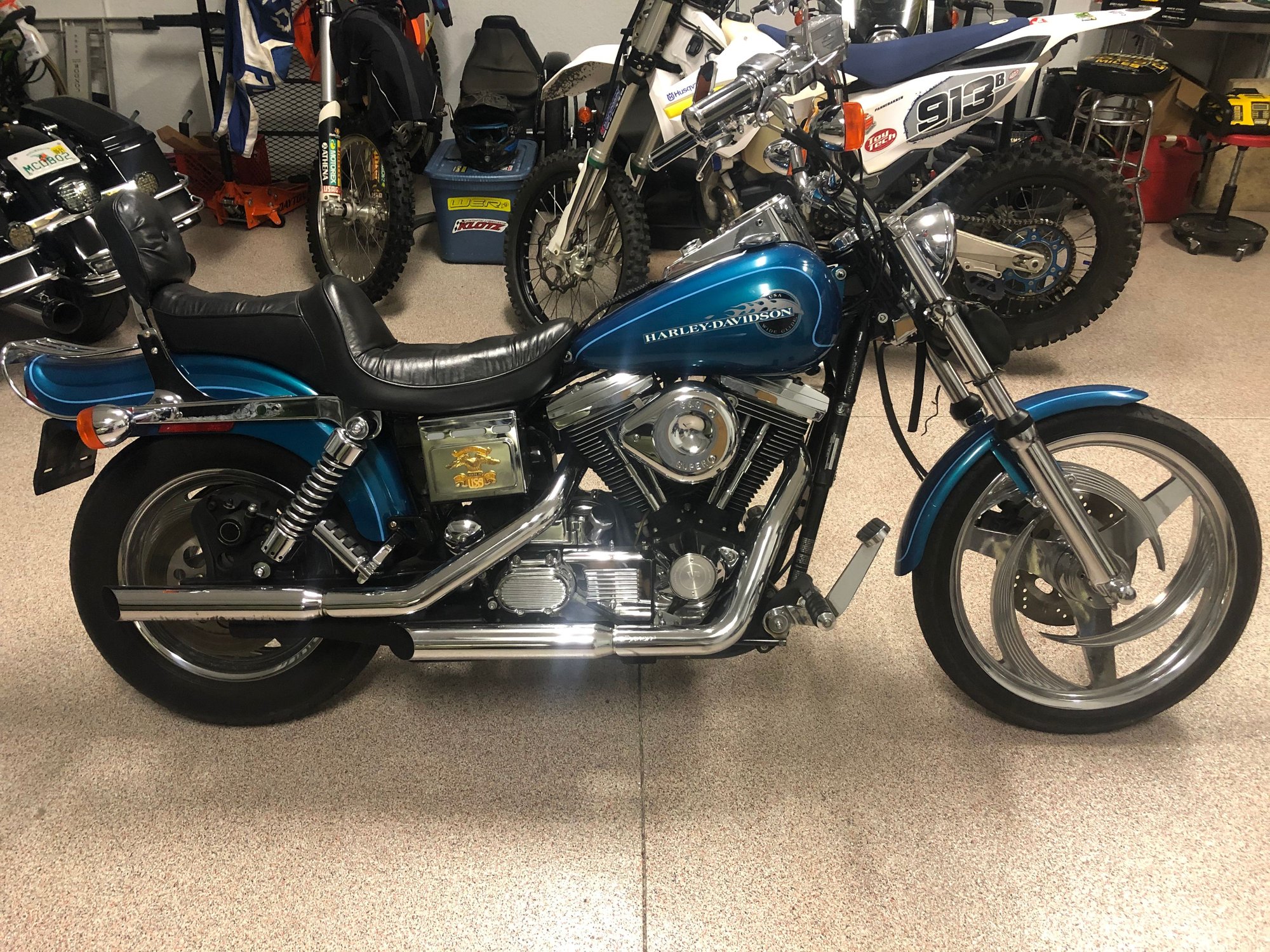

Just picked up a 94 wide glide with 12K miles. Minor oil leak from the oil pan after I ride it. Otherwise the bike is great and runs perfect. Can someone give me some input on pan gasket replacement. Any special tools needed? Looks like i can easily drop the pan between the frame rails but just looking for input on any surprises before I open a can of worms. Thanks for your help.
