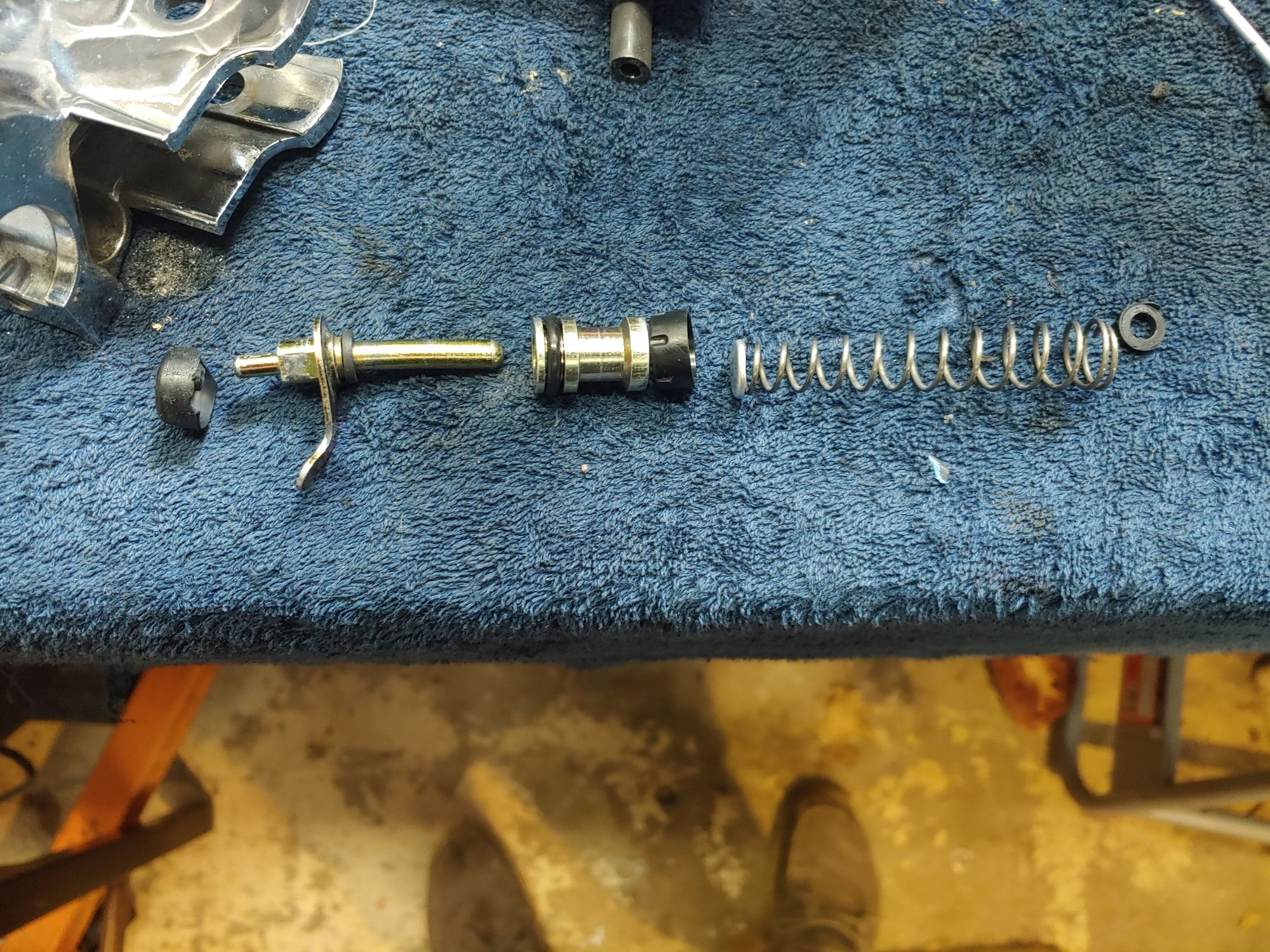

Now I am hoping that someone can help me out with what part I need. This master is aftermarket, but I don't know anything other than that. This isn't the components that I expected to see. The banjo bolt is 12mm and I am assuming that its an 11/16 bore. Hoping that someone knows what kit I need to rebuild this thing. I'd prefer not to have to spring for a new master. Doing some research its starting to look like this master is from a single caliper bike. Bore is 5/8".
I've always had better luck with the stock OEM stuff when rebuilding the m/c's on my scoots over the years.

So far so good. Master got rebuilt, bled the brakes for about 2 days straight until I realized the banjo bolt gasket at the master was leaking. new copper ones solved that. Bike runs real strong now. Just starting to open her up a bit with about 150 miles since the rebuild. Feels so much better than the dog that it was!
