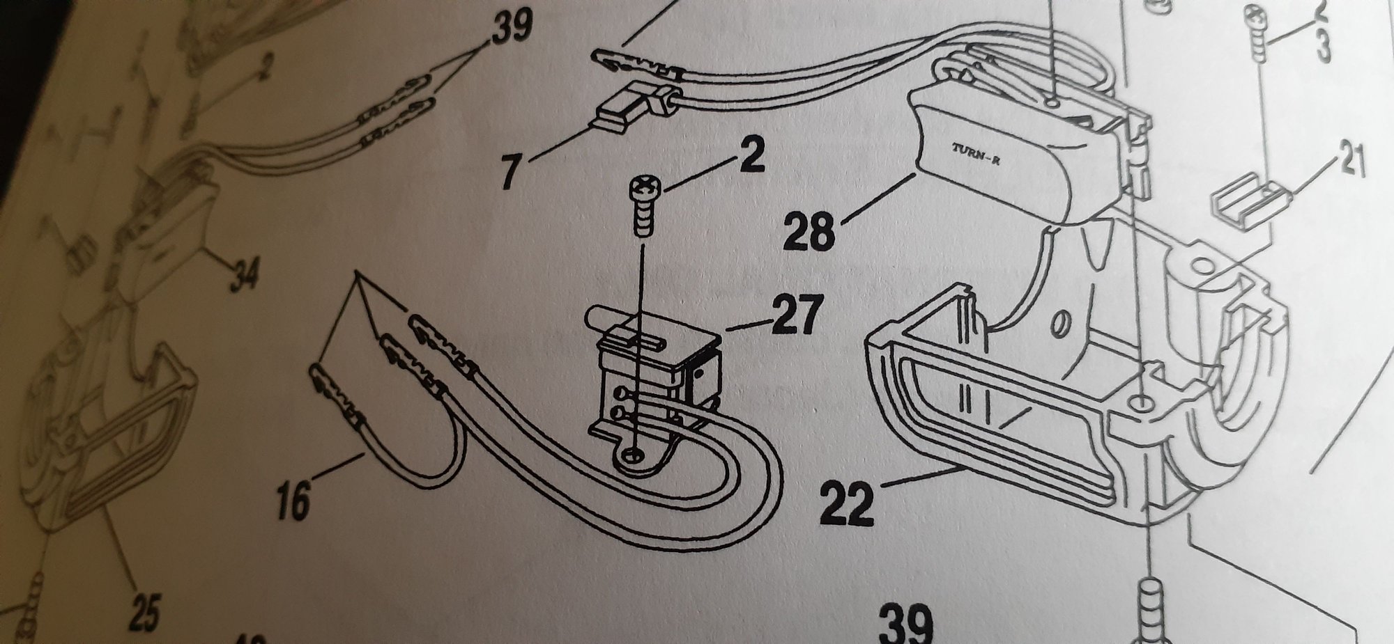

The wires meet at the connector under the seat. But you’re going to need to replace the front switch.
Its a normally closed switch and turns OFF when pressed.
Being we use the front brake more than the rear having them both working is a must.
you shouldn’t just disconnect it.

Originally Posted by mike131
I appreciate the photos but I'm not seeing this part at all in the parts catalog for a '93 Fatboy or part number

Geez. I was on the wrong page in parts manual. I found it and the part number.
OEM number 71590-92
thanks for the part number!
