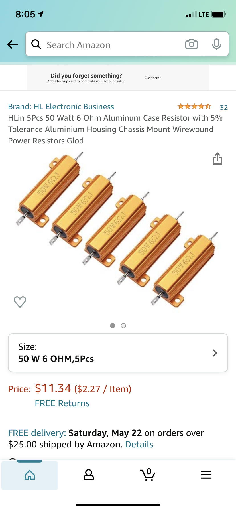

Amazon Amazon
this the one. Your suggesting

Originally Posted by robwlf10
Its not what I’d use... do a search for 6 ohm, 50 watt wire wound resistors. One side to the + of the turn signal the other side to ground.

Ty much. Gunna order them now.

You can find them with wire leads already soildered on and covered with heat shrink on the terminals. Might make your install a little easier, if you don’t have heat shrink and a soldering iron on hand.
