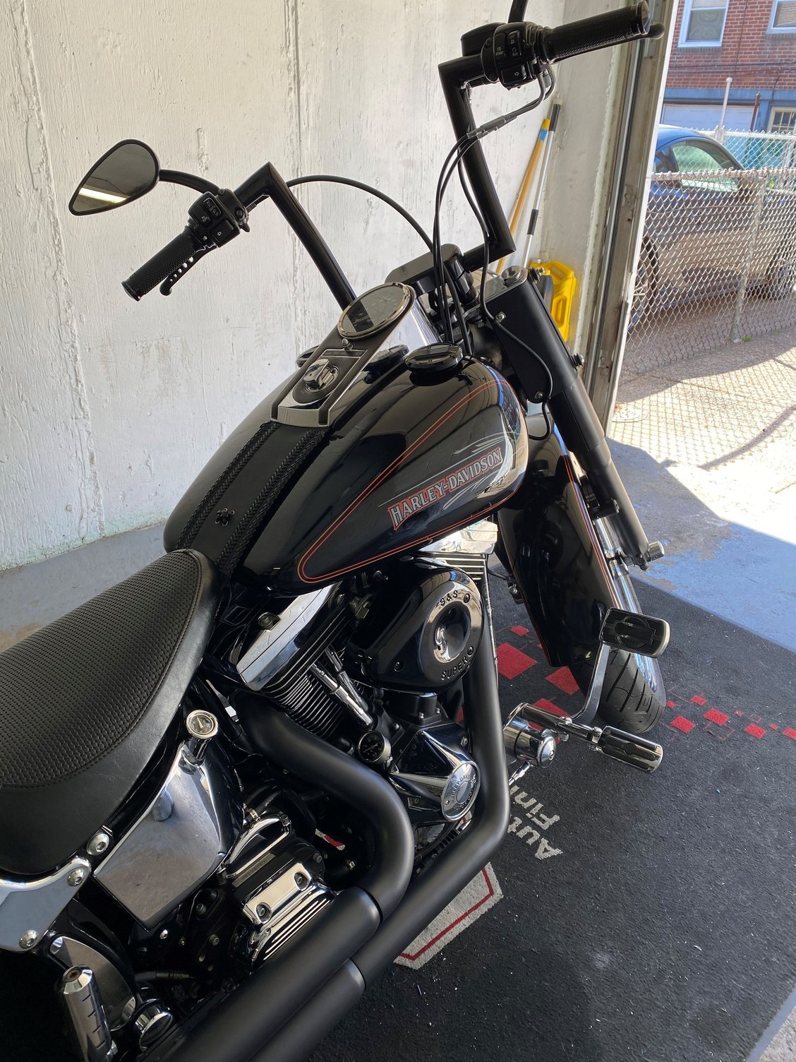

well finished up my install.. im very pleased how she looks and rides... and most of all its so much more comfortable..
no more wrists at bad angles. or shoulders always down did the whole shabang
new grips ,levers, mirrors... im done now for a bit thats enough for one yr.
between bars, lowering it, 21 inch front rim ,brakes, rotors, master cylinder,forward controls, exhaust... and painting stuff.. im spent hahaha
but love how it turned out currently

only issue im having. Is I disconnected the front turns. Backs work kinda. But dont flash. Maybe i shouldnt have disconnected the fronts. Till i relocated them to the tins
Sounds like you're running the stock turn signal module, but the rear bulbs alone aren't pulling hard enough to "wake it up".
Solutions are 1) Add resistors (they are called "load equalizers" in this application, which makes no sense to me, but that's what they are called) to the circuit or 2) swap out the OEM module for a Badlands or equivalent.
Ty
Not enough load on the system.
nother way of saying what Omaha said.

Np. Ill have to look into the resistor thing. I unplugged the front harness. Just incase i needed it later for something.
them resistors plug and play.or solder them inline to the wires
Did you go to LEDS??
WP
na still running the bullet light in the rear.
1157 bulb. I think
