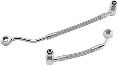

Anyone know where to get or how to fix fi leaking fuel lines? Seems everyone is out of stock.

I guess you have a 1995 FLHTCUI.
The unit with the TWO lines from tank. Magneti Marelli fuel injection.
Consider review of Goodridge brand HDFL005.
They are available from multiple sources
The price for both fuel lines is less than HD, the lines are of good quality and are also serviceable.
Note: They are silver braided and not black.
Below is a link for a Harley parts finder that will help you in future part identification.
http://partsfinder.onlinemicrofiche.....asp?make=hdmc
Here is another link for summit racing showing in stock. Double check what you have and what you need since sometimes folks change things through the years.
https://www.summitracing.com/parts/gdr-hdfl005

Ordered new lines through summit racing, the spoon trick worked great for removing check valve from the tank. Got it all back together and I'm pretty happy with this. No leaks! Thanks everyone for all your help and advise.
