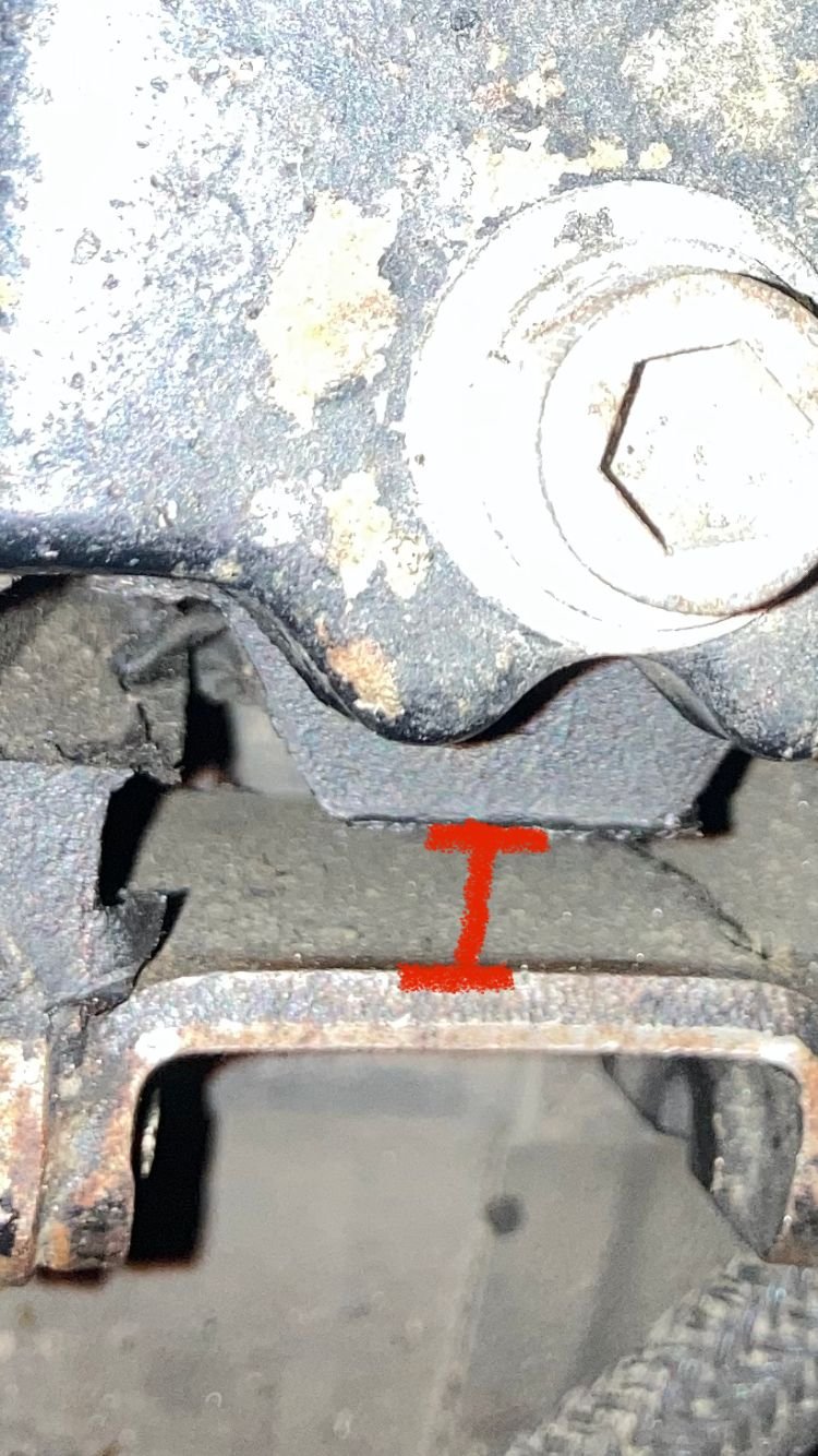

This was my front isolator
See that gap? Should not be there.
Here is a comparison between bad and good:
Someone on this fantastic forum sendt me the following picture:
Bad to the left
Good to the right.

Replace the front and the rear mounts. The front breaks down faster but a failing rear mount will feel like increased vibration to the back end. They are old, it's time to change them. Then look up how to do engine alignment in the factory manual.
Do a search about the mounts. There are posts showing how an oil filter change gets oil on the rubber mount which makes the mount break down faster. Also methods on how to prevent this.
