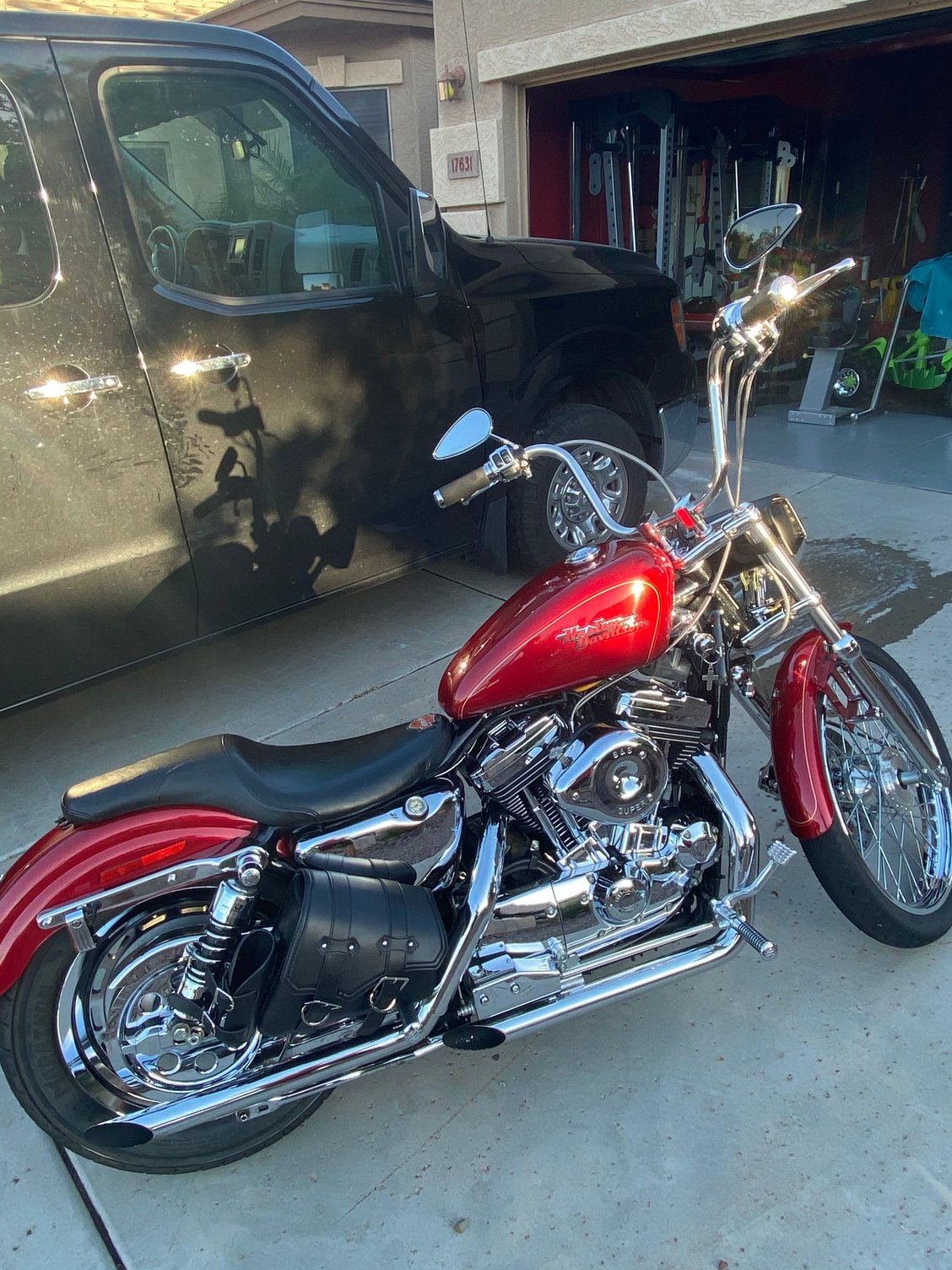

Nice looking bike.. I really like it..
flames out the exhaust might indicate an ignition problem.. Does it only do it when the engine is warm/hot.. OEM ignition module is in the case cover..

Really clean Sporty. Good luck getting it figured out. A lot of experienced advice here.
