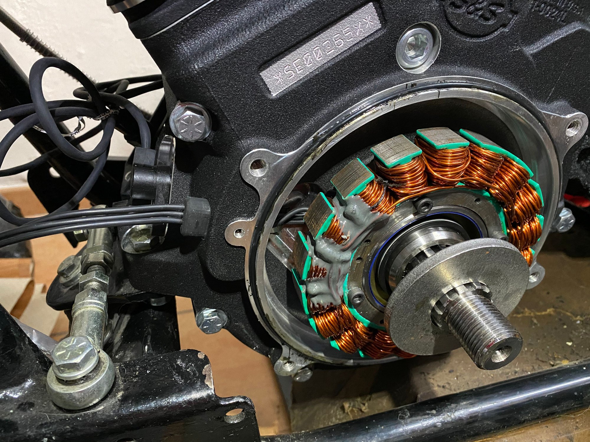

This is the seal on my brand new v 111, spring to primary side
