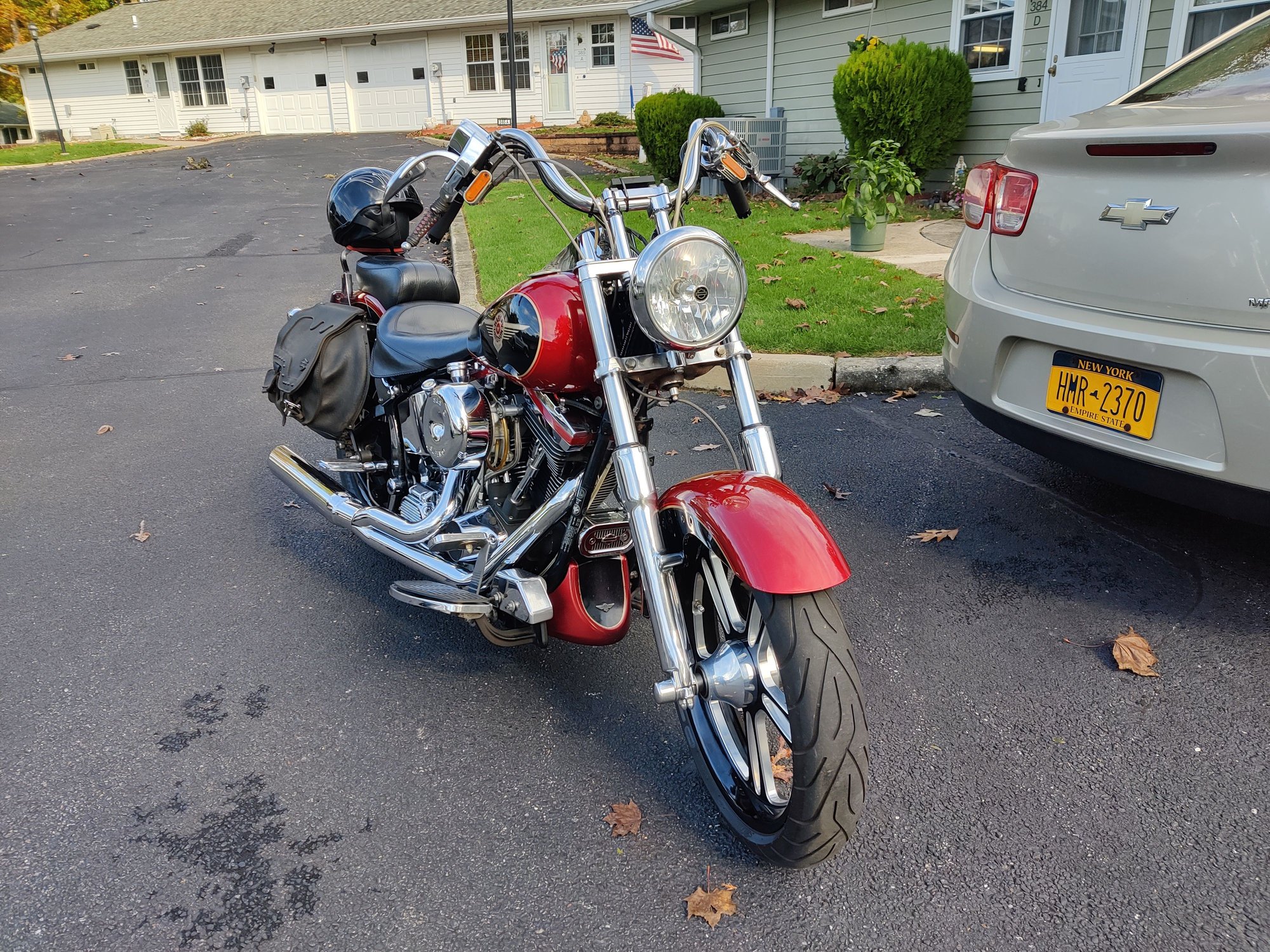

So I did take the tins off and am awaiting the 2" fork extensions along with a Sportster headlight.. should be here this week.. So here's a pic of the naked front end till parts arrive.. I actually had some seal covers left over from another kit to protect the slider seals..

My Thoughts...a stripped Heritage front end is essentially an FXWG.. without longer tubes...which is great for me...
With the 5" headlight it will be Cool...

Your son's Heritage looks great.. and yeah close to a WG.. It's actually a 1/2" narrower that the WG..
