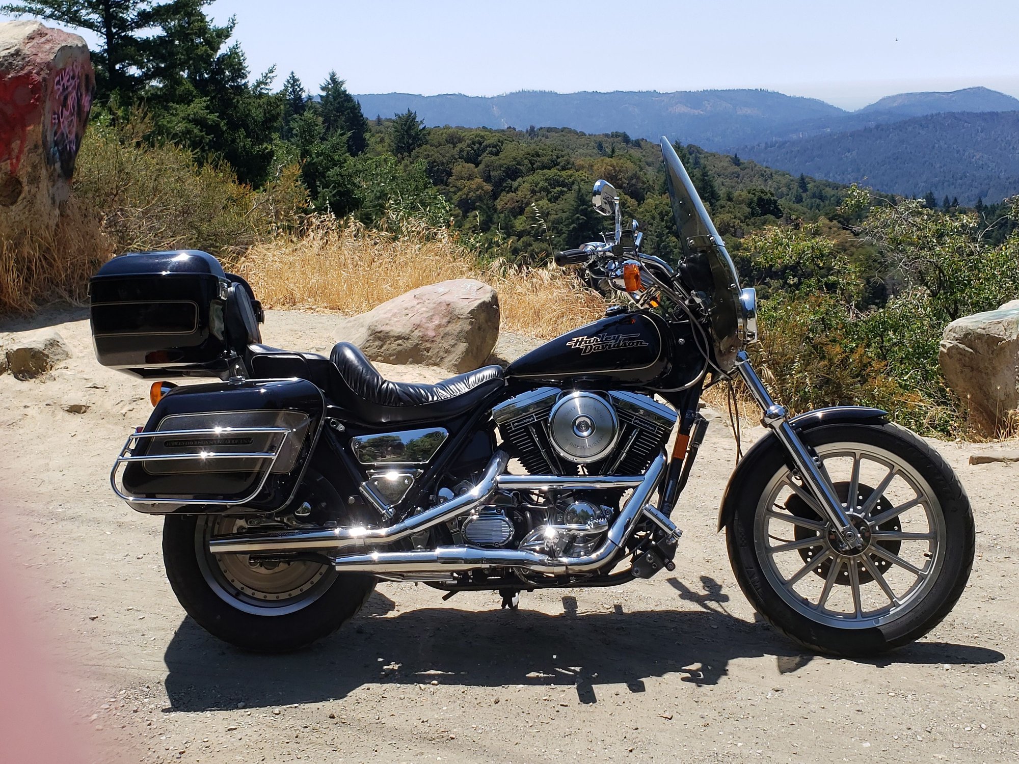

I bought these FXRT bags off of eBay and mounted them on this 1994 FXLR. It was a pretty straightforward install. I had to use FXRP/FXRT fender struts and relocate the blinkers.

The FXRT TommyC posted above would be the way to go, unless you already have the bags you're referring to, or can source them at a reasonably low cost.

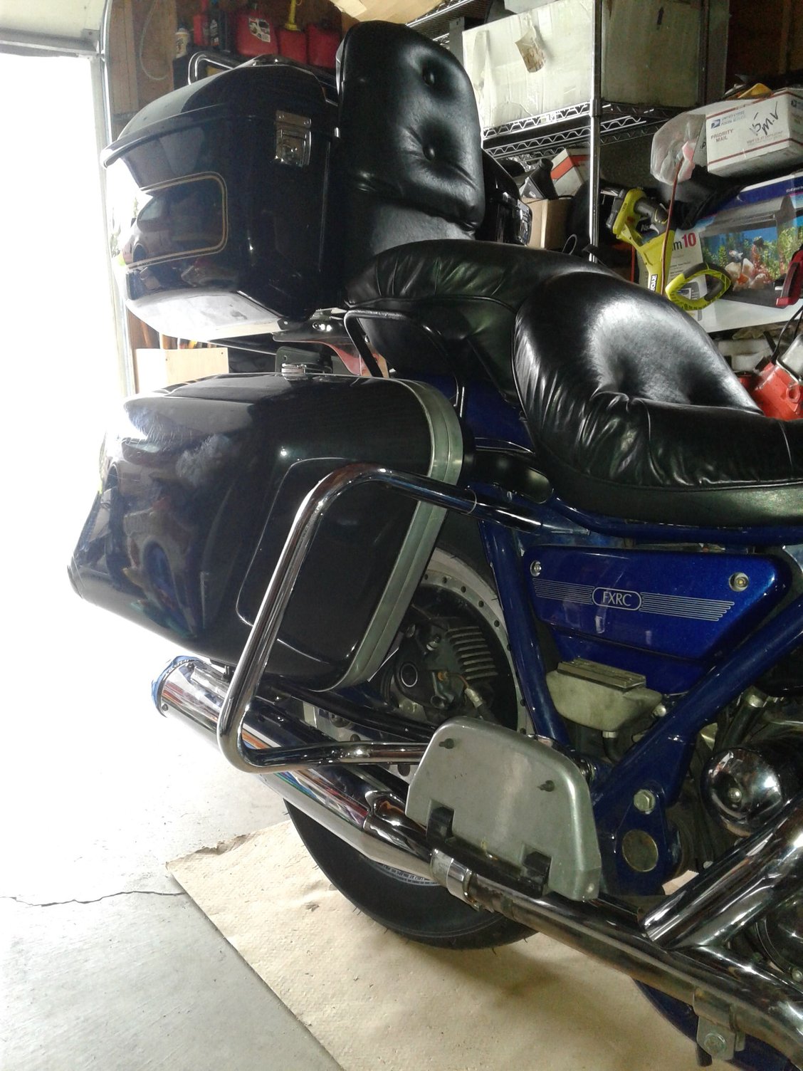

When I wanted quality saddlebags on my '85 FXRS, I looked around for FXRT/FXRD components and found them to be scarce and costly. In 2012 I decided to go with "Iron Bags". Not cheap and not HD...but VERY high quality. For someone like myself who is dedicated to keeping this one bike on the road...it's a worthwhile choice. If you trade bikes every few years, I'm not sure they're for you. Nine years and a LOT of miles later...Still loving them. The picture was taken when new...they still look that good when I keep them clean.
