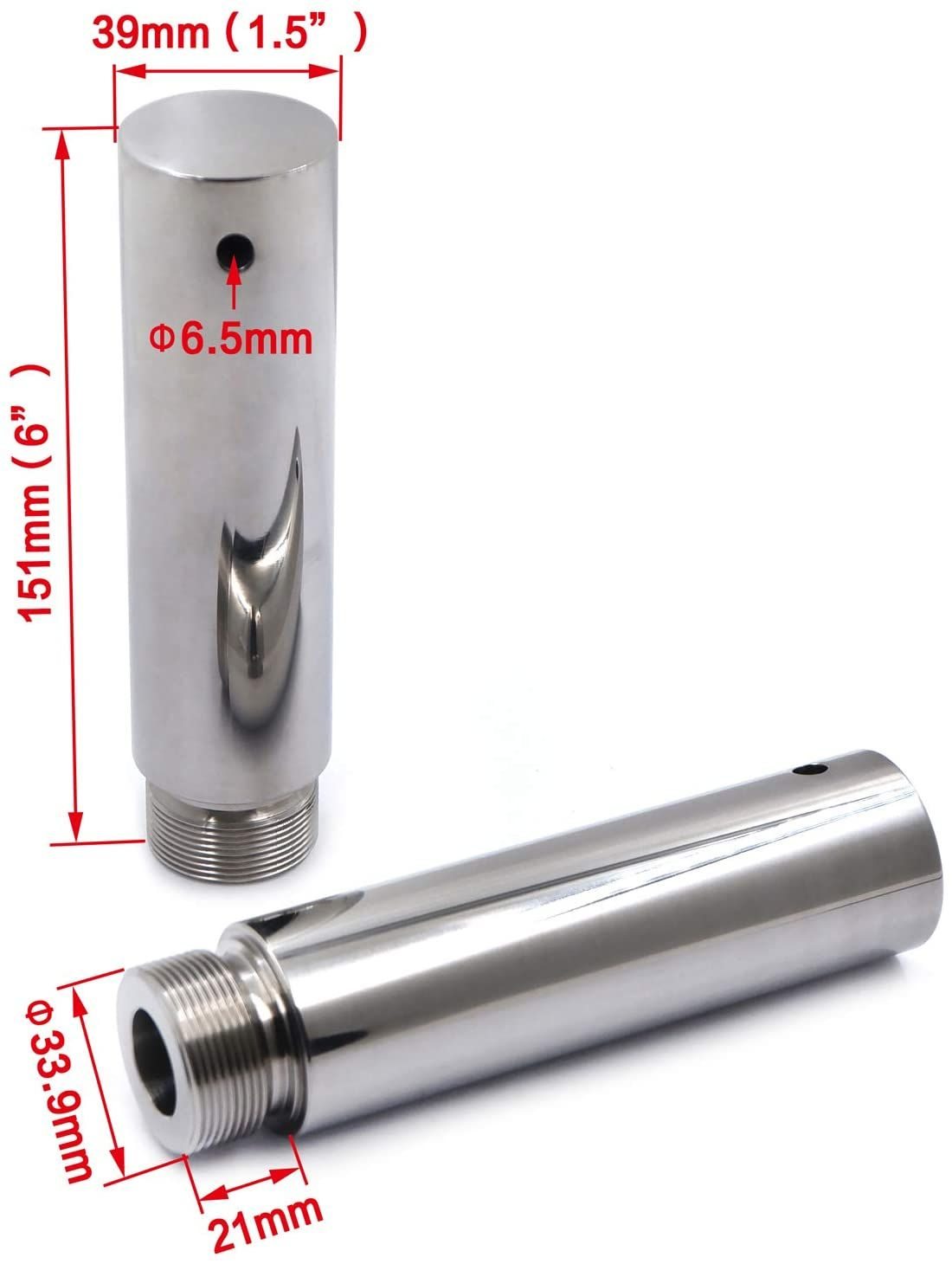

hey guys looking for fork extension on my sportster 1995 evo hugger to chopper it up a bit.. anyone knows dimensions? its 39 mm ??

Fork extensions are dangerous. Go ahead and grab a set of 4 or 6 over forks from TCBros or Lowbrow. That's the proper way to do it. Should be stock 39mm forks.
dangerous?
im looking for something like that ...

Do some research on them.
http://www.chopcult.com/forum/showthread.php?t=48852
I would not want to be riding if/when they fail. Do it the right way and buy some a good set of forks. They come with rebuild kits for your lowers. I ran 4 over forks on my old sporty and currently running 6 over on my shovel. Both kits from TCbros.

That explains why i cant find them on proper shops online only in china and couple of ebayers .. thanks ..

maybe a shop in Europe. for 4 over fork tubes? anyone?

The tube diameter is 39mm if it's stock
