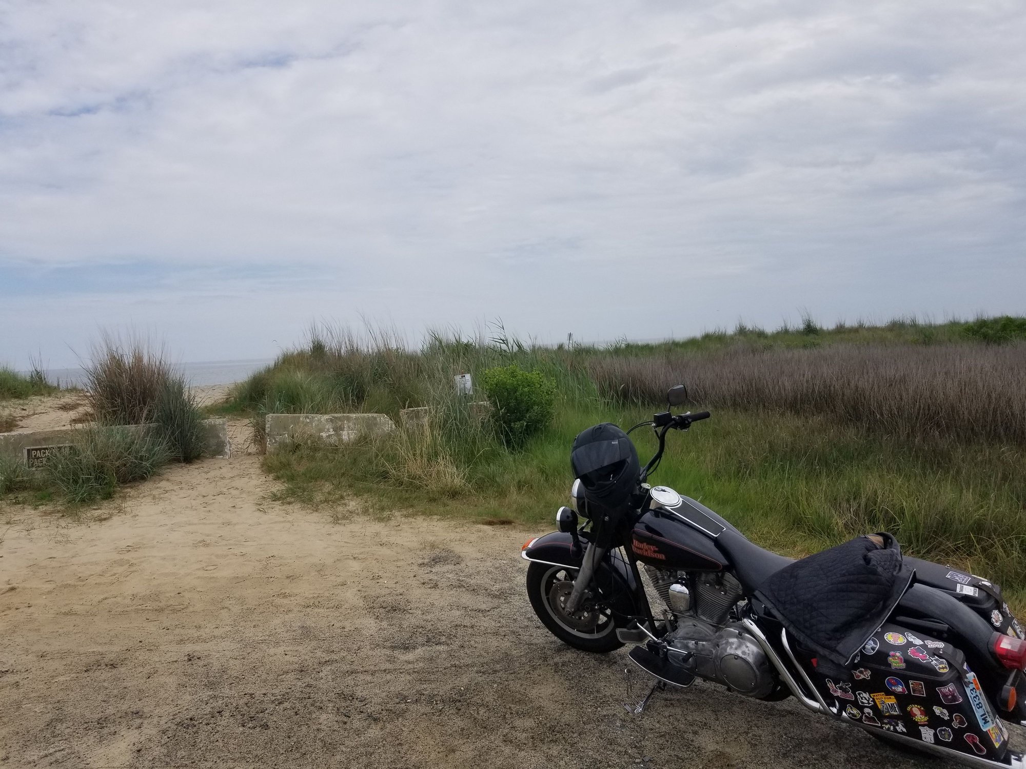

Like Road Master said, they're not troublesome issues unless you actually have them at the moment. You shouldn't have any trouble with your bike from the way it sounds. This is my 91, Trashy. Salvage title, 31k miles but it's still a great ride
