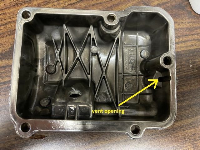

No, it's not normal to let your bike fall off the lift! Sorry - couldn't resist that one.
The vent for the transmission is on the left side of the top cover. Depending how far it was tipped over and how long it was left unattended, fluid could easily have gotten to the fitting/hose and run out a small amount. And it takes very little fluid to make a big spot on the floor.
The right side in this photo is the primary side where you can see the vent opening.

Most likely just slobbered a bit out the vent opening. Only 2 places they will normally leak - main seal or main shaft thru seal. They don't hold much and if you've not seen any on the ground before, should be OK. If it is leaking, it would be one of those seals and it'd leak all the time when riding, though hard to see. Just keep an eye on the fluid level via the dip stick (with bike straight up)

I should have asked - did it land totally on it's side or were you able to catch it?
Meaning, if it was only at a 30 - 40 degree angle, (as it the crash bar caught it before the handle bars were on the ground), then no, it shouldn't have leaked out the vent.

Not "good" but thank goodness for the bags. Yeah, with the mirror on the floor, I'll stick with my "out the vent" guess
