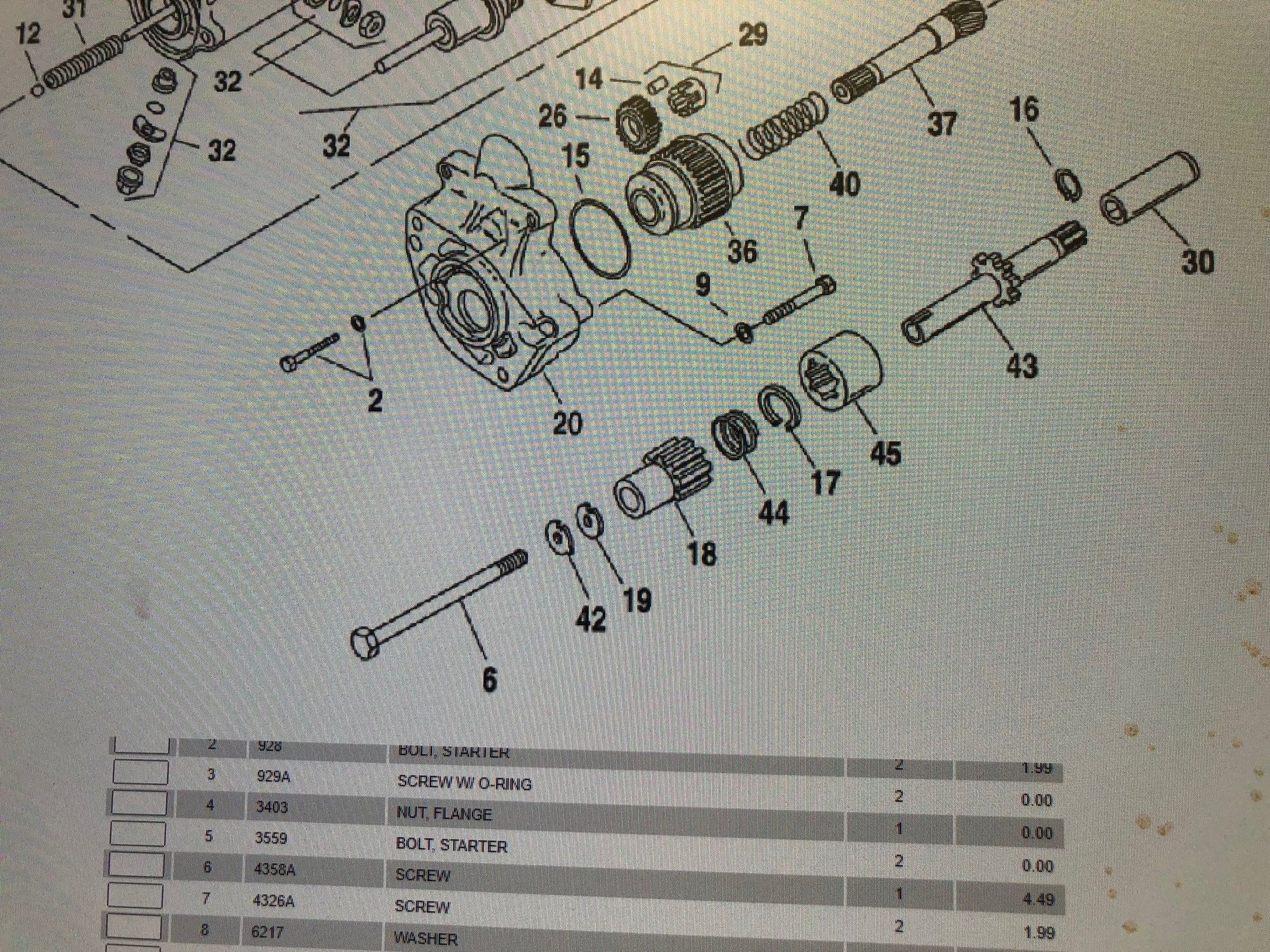

Bolt # 6 is 10-32 X 5.25" So you always worry about breaking it
Use your favorite thread locker

Under the front inner primary seal. Removed the "of the" - So the big o-ring between the inner primary cover and the motor. Where the stator is. Clear?
